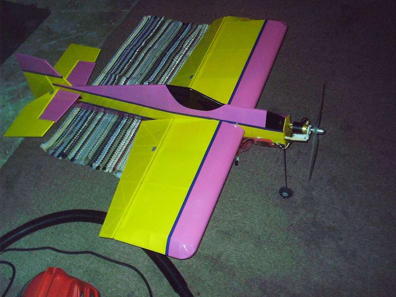

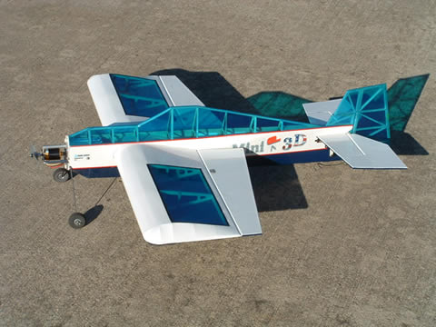

This was a fun little conversion. Certainly the easiest that I have done to date. The plane is impeccable out of the box, however I decided to recover since Chris and EFRC is local, I knew there would be more than a few at my field (and I like to be different). My wife and I sat down to watch ER and by the end of the show, we had the covering removed. I used white Ekonocote and Dark blue as well as Trans. Blue Solite and in two evenings, I had it recovered. I hope to get some flights on it this week. At just two clicks over half throttle is wants to pull out of my hand, so I think I have choosen the right power for it.
Wingspan: 38.5 inches
Length: 45.9 inches
Wing Area: 530 sq. inches
Weight: 34 oz.
Power: AXI 2820/10
Prop: APC 11X5.5
Battery: 3S2P 4.2ah TP's
Amps: 22
Fnished plane, Motor, Servos, Hatch
Length: 45.9 inches
Weight: 34 oz.
Power: AXI 2820/10
Prop: APC 11X5.5
Amps: 22

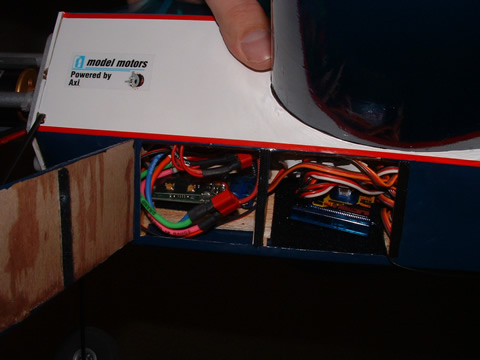

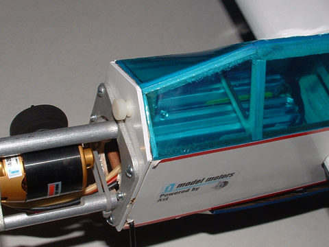

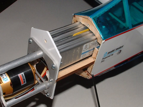

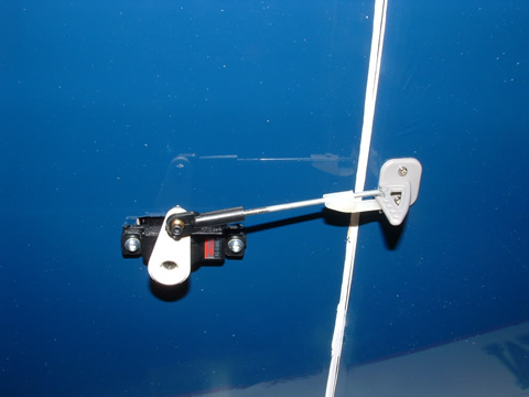

This shows the 3S2P slid in. There is velcro on the bottom of the plate it is resting on and the top of three formers keeps it from moving elsewhere. The front plate is held on by two 8-32 nylon bolts and blind nuts epoxied in. One on the top and one on the bottom.

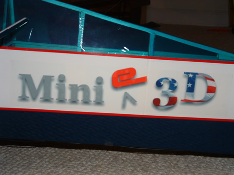

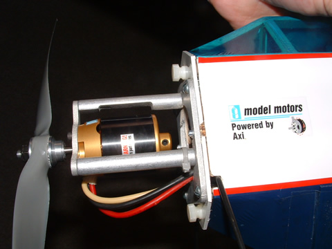

The second picture shows how the pod slides out and of course the third picture is a homemade decal that informs of its intentions

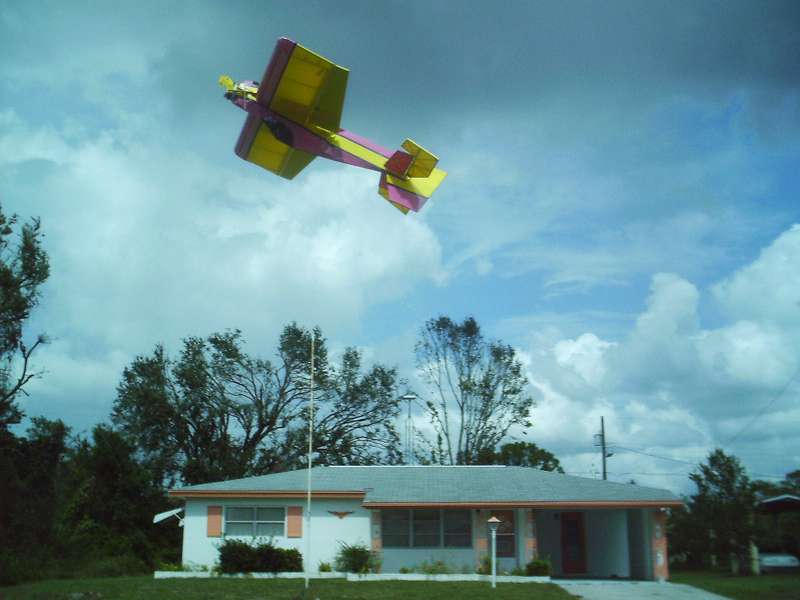

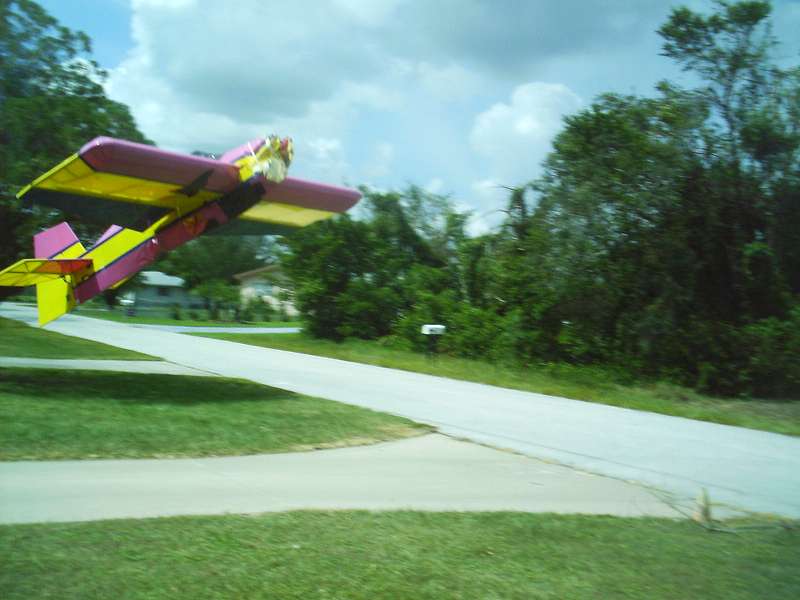

This is Andrew. I flew this airplane today. I thought it flew great. Crazy snaps and it had unlimited vertical. First flgith was great but then when we switched to li-po, I was doing some blenders, then tail spins to flat spins and all of a sudden the plane went out of control and i had intermittent elevator in a tail spin. It just dove into the ground barely missing the road.
The AXI 2820/10 needs the magnets glued backed on half of them. But my dad cannot get the can off. The allen nuts are too tight. HELP?!? [:@]
