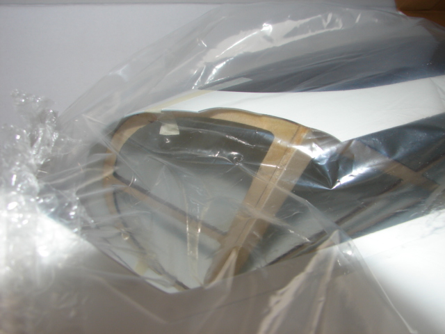

Well, I unpacked my Seawind this morning. Everything was fine except some minor damage to the canopy. I have already written to Tower, so hopefully there will not be any issues with getting a replacement. Dang, this is a big airplane with almost no wing. It's really a nice piece of work. GP needs to hire a packaging Engineer however. Helloooo....
Cgrain, I don't believe a 2826 would even come close to flying this plane, I just to big/heavy with to high a wing loading. A 4130 would even be marginal IMO. But I'm going to do more motocalc work and see what I can come up with. Now at least I can weight the bits and have a better idea of the empty weight.
