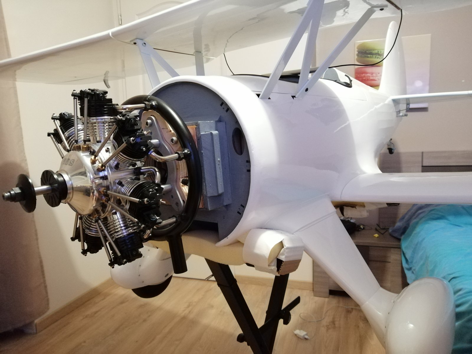

How are you mounting the radial? I'm still trying to figure out how to mount my 7-90.
I'm sure this has been answered 1M times, but whats the grease coming from out of the radial near the pushrod base? There is a decent amount that comes out everytime I run it. Is it a defect or a feature??

Are there any issues with mounting a 7-90 90 degrees to the side?

Voici le montage que j'ai fait pour le 7-77, une première plaque de 10mm collé et visé sur la cloison moteur, et une deuxième plaque de 22mm qui a la forme du support moteur
