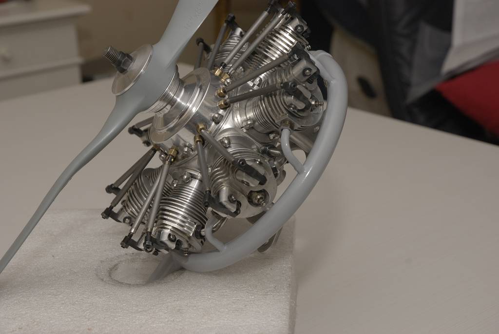

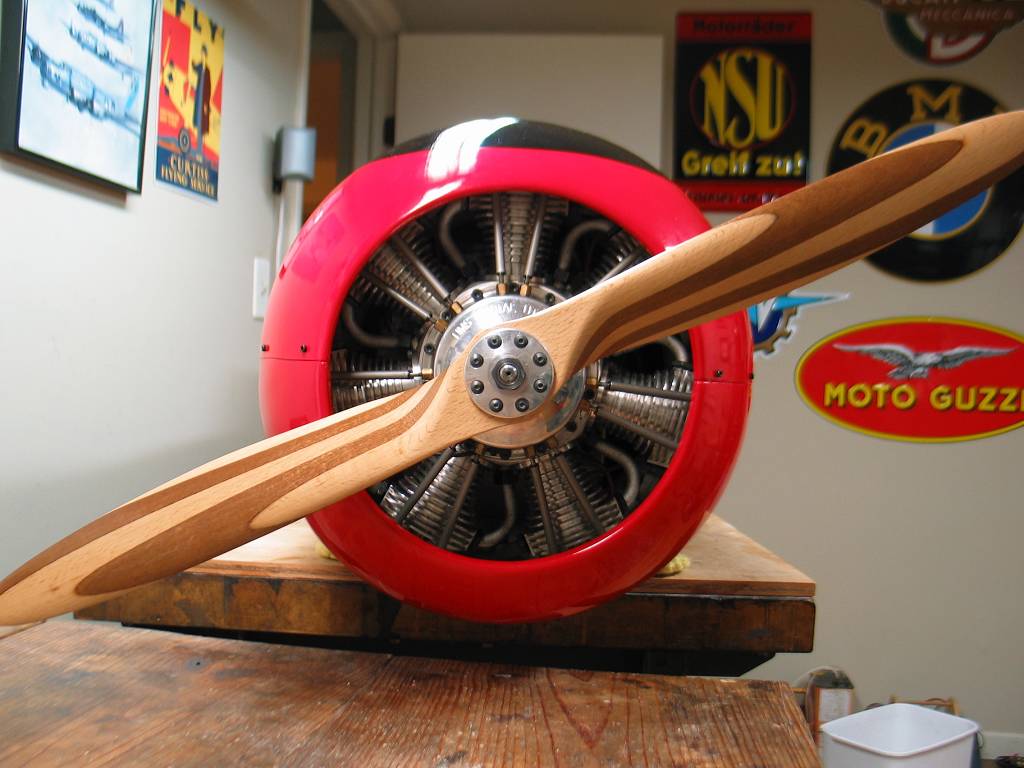

Well Mitch a collector ring will be cleaner and sound deeper. That plane will be outrageously cool! Lars, here is a photo of the 160. I call it the 10 10 10 engine! (+- 10%). 10 cu in., 10 or so Hp, 10 out of 10 in running qualities, 11 pounds with ring and 11 inches in diameter and insanely low vibration.

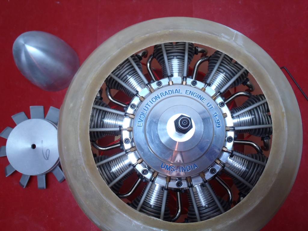

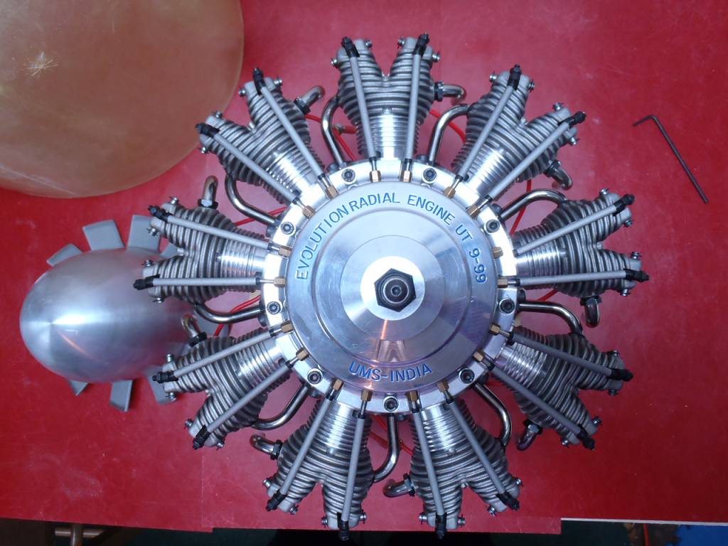

<span lang="en" id="result_box"><span class="hps">Exhaust</span> <span class="hps">Ring</span> <span class="hps">from</span> <span class="hps">Keleo</span>
<span class="hps">mounted on the</span> <span class="hps">seat</span> <span class="hps alt-edited">fit nicely</span> <span class="hps">and</span> <span class="hps alt-edited">easy to install
Lars
</span></span>

Congrats Lars! You will find the engine will sound better and deeper too. Cleanup will be easier. Hey that grey color matches your plane! Will it go back on the Stearman? Lars, what propellor is that? -Tom

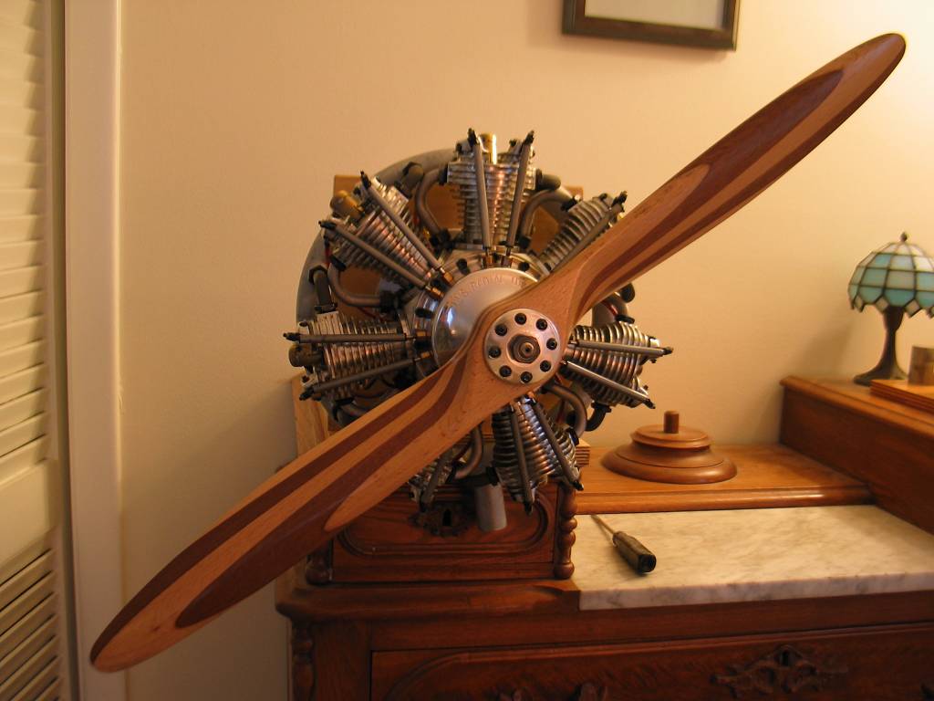

Lars, What I liked about that propellor was, unlike the APC it matches the drive washer diameter and looks much better. -Tom

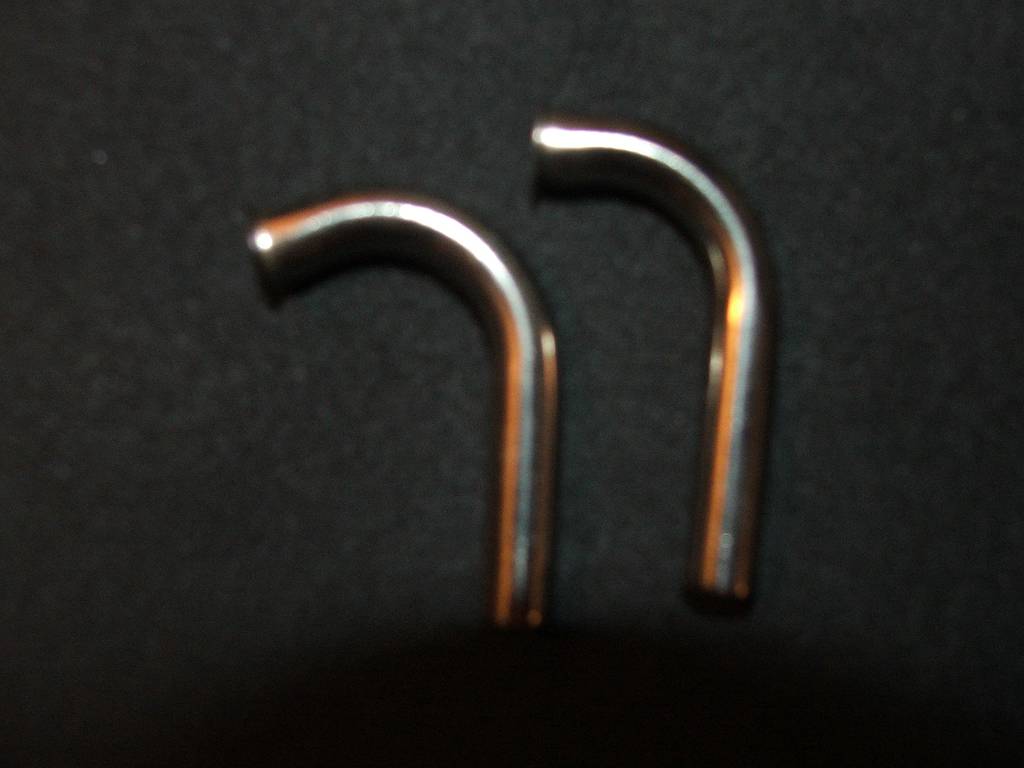

Has anyone ever taked to someone at Horizon Hobbies about a warranty issue?
After looking over my EVO777 I had notice that one of the exhaust tubes has a different radius than the others.
It looks like it may have been an intake tube used as an exhaust.
I sent a picture to HH but the only answer i got was to call back earlier in the day to talk to an engine person.

Just call our product support on Monday and they can send you a new package of intake/exhaust tubes. They come packaged as a set.
1-800-338-4639
Pete<br type="_moz" />

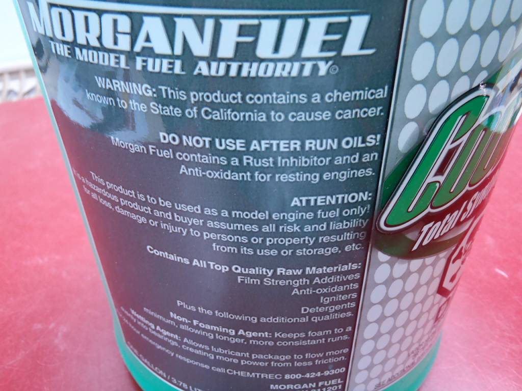

Hi,

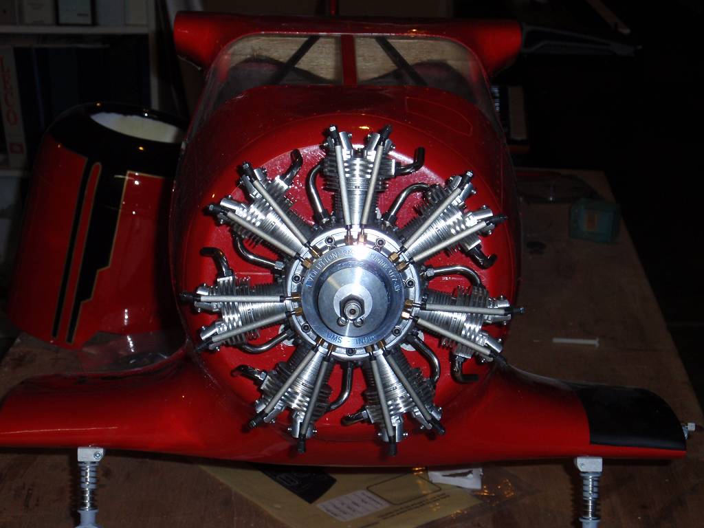

I just got the Evo 735 to put on my Staggerwing. I notice that the oil content can be quite low for this engine. Was 10% with the ester based oils that are more common in Europe or the PAG oil that is more common in the US? Would it be OK to get some Cool Power 10% Nitro ( I think it has around 20% PAG oil ) and mix it 50/50 with Methanol to get 5% Nitro and @ 10% oil?
Joel

Yes that would work perfectly! Its what I did, Just dilute a good brand of glow fuel with high quality methanol. I do not know about the different oils you mentioned. Perhaps Pete could answer your question in the oil type differences. -Tom

Ester based oils are synthetic oils and the recommended Evolution Oil is of this type. PAG oil's are generally mineral based oils and will work well also. Your solution for fuel is spot on (Cool Power tends to be about 18% oil which will give you a 9% mix when combined with the straight methanol).
BTW - The installation looks great on that airplane!
Pete
PS - The collector rings for all the engines will be available shortly - we are waiting to receive the instruction sheets from the printer.

Isthat combination (Cool Power 10% nitro /18%PAG oilthen mixed 50/50 with Methanol)good for the break-in of my EVO 99cc 9 cylinder?

Beasly, Same fuel for all the glow engines. -Tom

Yes. That will work fine

Thanks guys...
Picked up a gallon of the Cool Power w/ 10% nitro and 17% syn oil... Didn't have time to get the methanol today, but "hiperfuels" here in the Houston area sells it in manageable quantities. The fuel color is much more green than in the picture and it recommends NOT to add any after-run oil as it contains it...that's a time saver.
I will try to get a video of the break-in of the radial and post it. I still need to order my 25" Solo Prop for the FW 190 A version. Going to get an off the shelf propto use during initial break-in until the big boy arrives.
Thanks again
