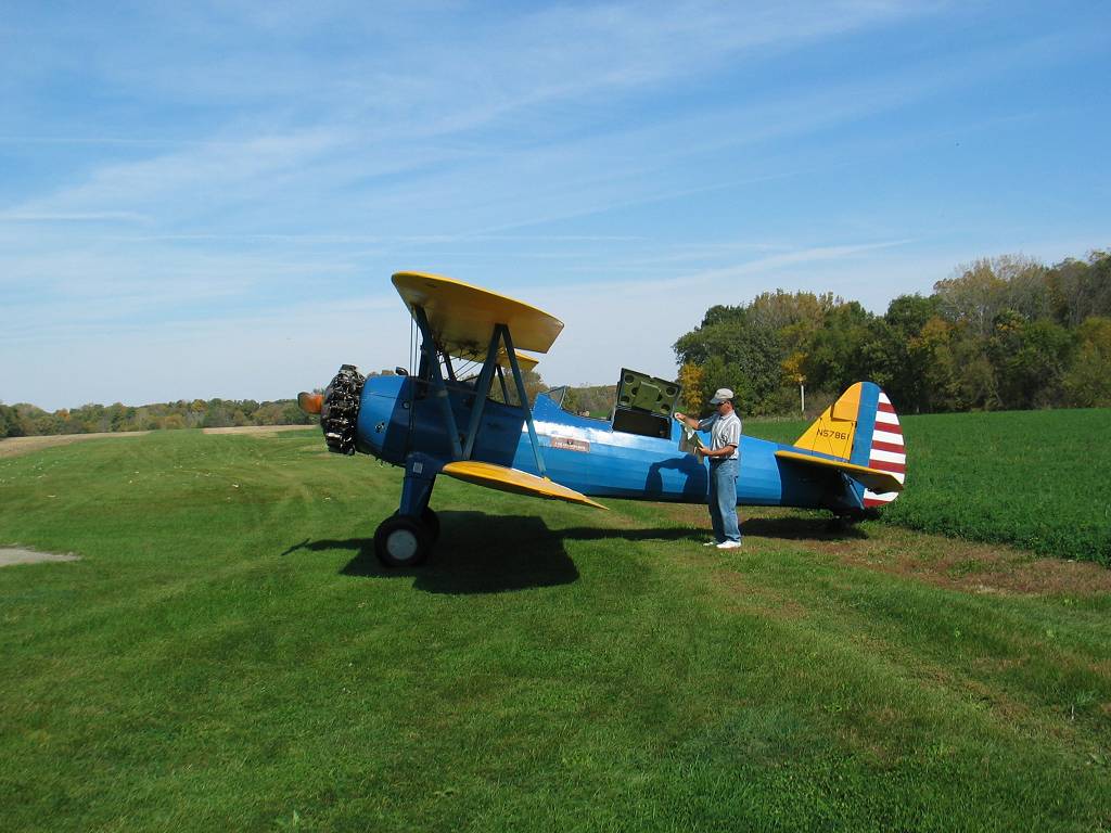

Old 03-27-2013 | 03:04 AM
  #754
My Feedback: (62)
Joined: Jul 2005
Posts: 1,190
Received 16 Likes on 16 Posts
From: Indianapolis, IN
Default RE: UMS Evolution Radial Care and Operation
Engine smaller in Diameter?? Here is an original with stock engine that I flew in. -Tom
ID:	1867136   Click image for larger version
ID:	1867137   Click image for larger version

Bandangle
What is the diameter of the 87 inch cowl? Looking at the full size photos that Maxam provided, indicates that the engine should be a bit larger in diameter than the fuselage. If it can be reliably shown that the 7-77 will fly a 30+ pound airplane with reaonable authority the 87 inch version may indeed be the way to go if the engine looks right on that size model. I really want to build a Stearman without a cowl and without a dummy engine, but if I am going to spend that much for an engine it has to look right. The BUSA 1/3 scale Stearman flies great on a five cylinder Moki and sounds very realistic but it isn't SCALE.
Old 03-27-2013 | 04:50 AM
  #756
Joined: Feb 2010
Posts: 192
From: springhill, FL
j lauria sorry guys, the photo I have shows a smaller engine but after searching I found planes with engines a bit bigger than fusealage. </p>
as realistic as rc models are im not sure if my photo is a real plane or not.. its not a close up photo.</p>
I don't have planes for 87" yet and no cowl listed for it so I cant say as to diameter but should be closer to 9". Question...WHY is 77cc radial </p>
not as strong as 77cc single? </p>will single take same prop as radial?
