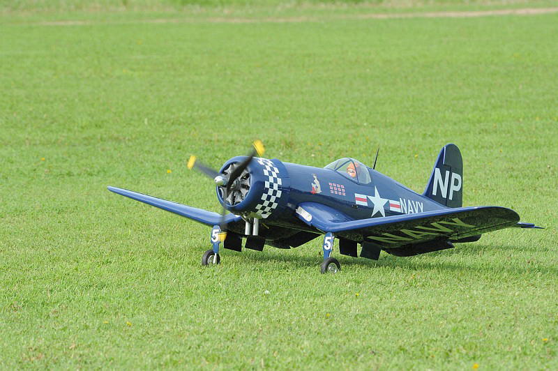

Maxam
I sure am glad that you started this thread.
I just received my EVO 7-77 on Saturday.
What a good looking engine.
I have a BH 90" corsair that I have been running a DLE 55 in this summer.
I have been aching to put a radial in since I got it. Now this winter project can begin.
I had e-mailed VP products to find a local distributor of M1 methonal.They gave me a place that is 10min away and they sell it for $6 a gallon.
I am planning on mounting it on a test stand to run it and tweek it.
I had purchased some 1" 7076 aluminium rod to make the stand offs out of but, if I don't think that it will be enough surface area then I will modfy the firewall.
