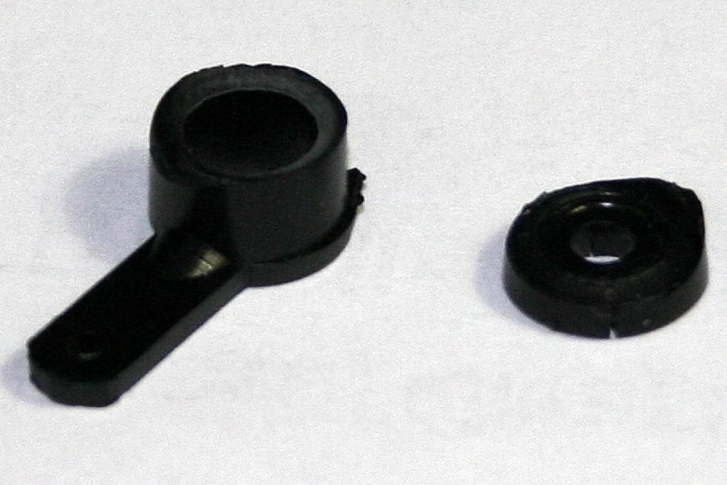

Up date. Well I kept the non-pump carb and used a Iron Bay fuel regulator with it and it worked really well. The little Super Tiger GS45 handles like a gas engine now.
One quality related problem I did encounter with the carburetor. The throttle arm broke wile I was adjusting it's position. I was tightening the screw when it popped. I was using a jewelers screw driver with index finger and thumb and never felt any back pressure as if I was crushing the arm.
The arm is similar to the arm found on OS FP engines. It's a hard brittle plastic that looks to me like it wouldn't have stood up to much use.

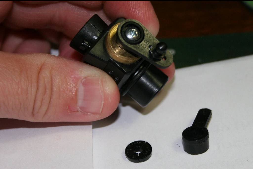

Looking at it reminded me of an servo control arm. I had some nice Du-Bro deluxe control horns in a drawer so I pulled one out and fitted it to the carburetor.

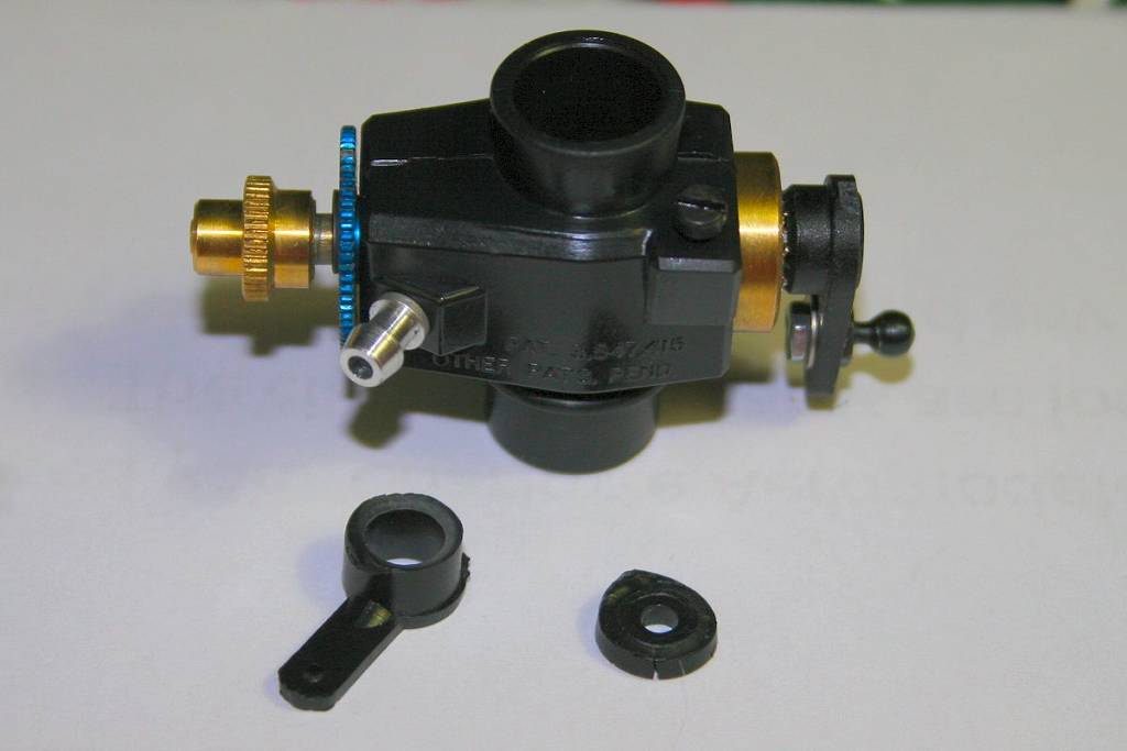

It worked out perfectly and looks like it was made for the carburetor. Being made of a thick fiberglass reinforced nylon I have no doubt that this arm will last. I'll be upgrading all my Perrys this way.

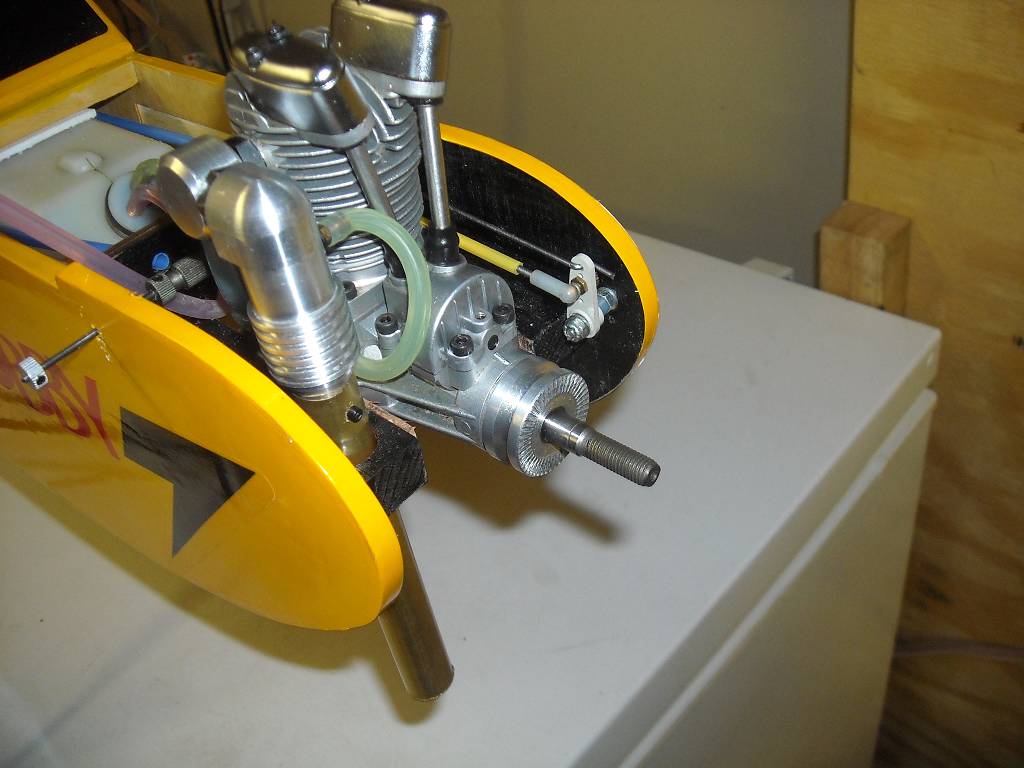

Servo arms are indeed handy, I keep all the extras O can get. They make good, "Swing levers" where carbs are too close to or above the firewall.

Looks good! as well as your Telemaster. I know that is a joy to fly with the Saito in the nose.
