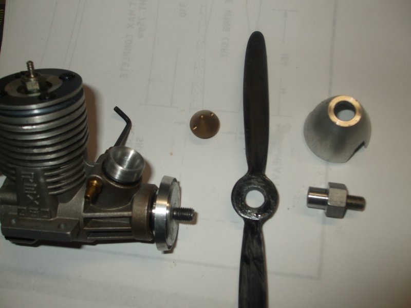

I am wanting to do some bench testing on some of my car engines. The best way I can figure to put the same amount of ''load'' on each engine is by using a prop from a plane and then take RPM readings off of the prop. but I am not sure how to attatch a prop to a car engine that has an SG shaft. I could use a threaded clutch bell and drill the hole in the prop out enough to get it to fit over the threads but I am not sure how i would get the engine started from there since all my engines are bump start only. can this be done somehow? Does anyone have any ideas for me?
Also, any one know of a tach that reads higher than 32,000 RPM? Some of my engines will crank out over 40,000 RPM and the mini hand held tacks I have found only read up to 32,000 RPM

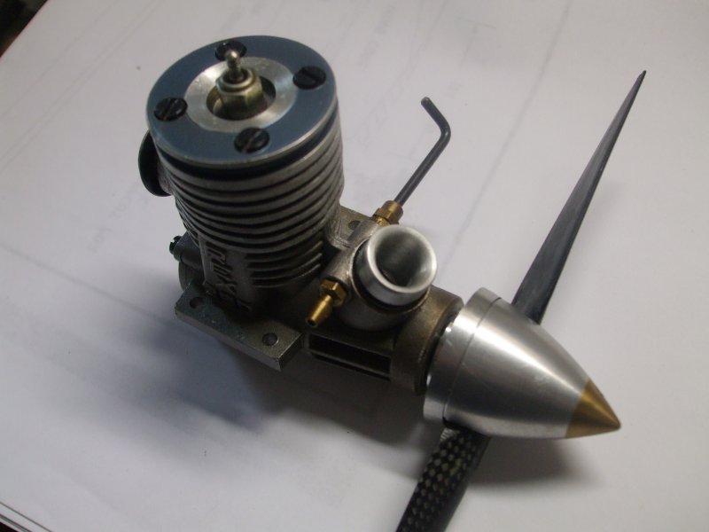

Ok this is quite easy to do actually. Often .21 sized Buggy and .12 sized car engines are converted to Control line speed engines.
The first pic below shows a Nova Rossi Buggy motor that I've converted. The technique can also be applied to the smaller .12 sized motors as well. The major mods are obvious. The head fins has been shaved off and lots of metal has been removed from the crankcase. What's relevant here is that the small protrusion (for the clutch assembly?) on the crankshaft front has been dremeled off.
The pics tell the story:
A sleeve nut threaded M6 x 1.0 has been made. This is all you really need besides the prop driver. I made mine out of 1/2 AF Aluminium hex bar.
A short M6 x 1.0 stud (off a bolt) screws into the other side of the sleeve nut for the spinner point to screw into. You don't need this so the bit on the shaft can be left there.
Notice that the whole spinner assembly (off an OPS .29) fits on the shaft via a standard tapered collett. Any suitable propdriver of the right size will do.

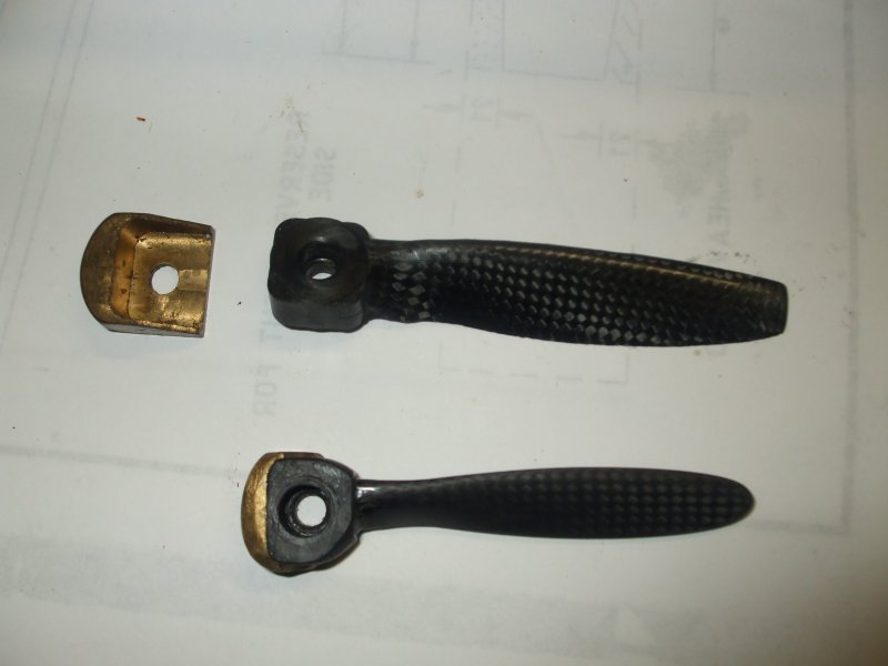

The prop for the .21 is a 6.5" x 6.5" Carbon Fibre, it and the single bladers below are obtainable in the US off c/l speed suppliers. I can give you the contact.
I'm guessing that your engine is a .12 so a two bladed prop will be too much of a load.
You need a single blade CF prop. Notice the brass counterweight. The assembled prop balances perfectly on a model aircraft standard prop balancer. You can see how the blade is trimmed and then the brass counterweight is shaped till the whole thing balances.
These props are made for .15 sized c/l F2A speed engines which rev into the 40K range. You can see these in operation on youtube.
With such a prop the .12 car engine can easily rev into the high 30K or low 40K with safety. CF props are very rigid and incredibly strong.
The nice thing is that the problem with your tach just goes away with a single bladed prop. The tach will read half RPM so you just double your readings.
apparent 20K = real 40K.
For starting I'd suggest a simple sleeve nut with a hole for the protruding part of the CS in the front but shaped so you can use an aircraft starter.
I'd leave the r/c throttle and the head fins on!
