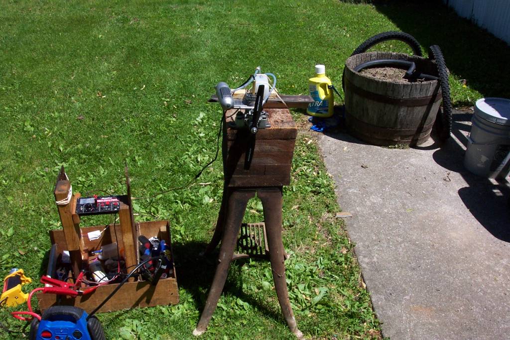

Hey folks. I am looking for ideas ( and photos) of test stands that others have built, for breaking in new engines. I have a new .46, a Saito FA100 and will have two more for the Twinstar that will come soon. I am thinking of 1/4 " Aluminum, as I started off my working life as a Machinist, and have access to a milling machine. I would also like to clamp it into the B&D Workmate.
P.S. Can I make this one size fits all? I know I will have to drill and tap for different engine mounts.
Any help would be greatly appreciated.

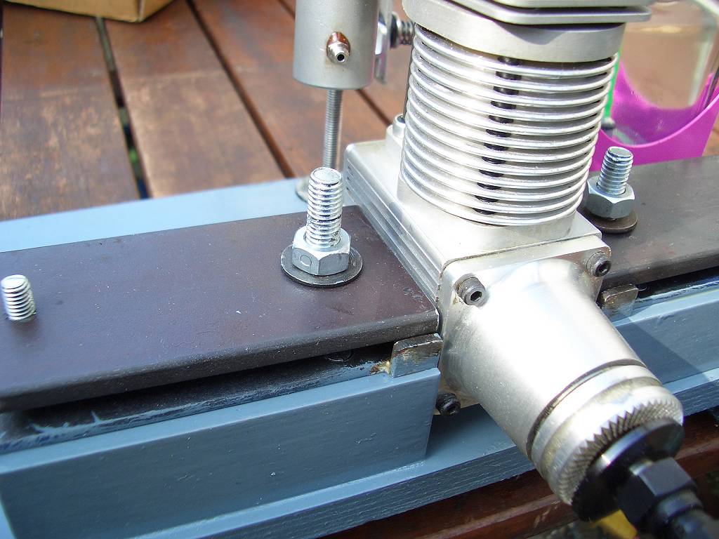

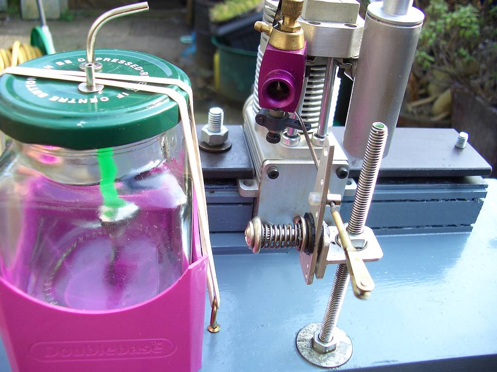

Here's my stand; all made from scrap components.
It is fastened to the outdoor table, using the 6 mm bolts and wing-nuts.
The clamping mechanism is made from flat steel bar, top and bottom. The lower bars are screwed to beechwood blocks. One of the blocks is fixed; The other slides so as to accommodate a range of crankcase sizes. My smallest crankcase is a .30, the largest is a 1.80.
Each side of the clamping mechanism has a small tongue soldered to it, such that the engine is prevented from sliding forwards in the event that the clamps should loosen. There is a screw fitted to each of the upper clamping pieces ... this provides the facility for the clamps to be "parallel".
The throttle lever has a friction mechanism and the assembly can be turned on its post, such that it will accommodate a carb which is mounted on the left or right of the test' engine.
The rest is self-explanatory, I think.
If I'd had the materials available, I'd have used all-metal in the construction ... but I didn't, so I made do with beech and ply.
The engine shown is an un-run Laser 100, which belongs to my mate. He insists that I take it and use it, for some reason. Shouldn't we all have mates like that? Anyway, I don't yet have an appropriate airframe for the engine ... but I might just run it for the pleasure of seeing it and hearing it.

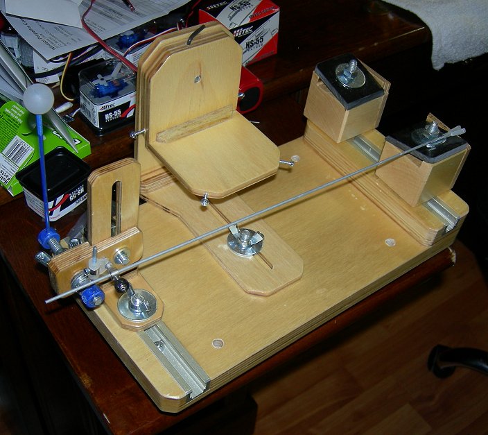

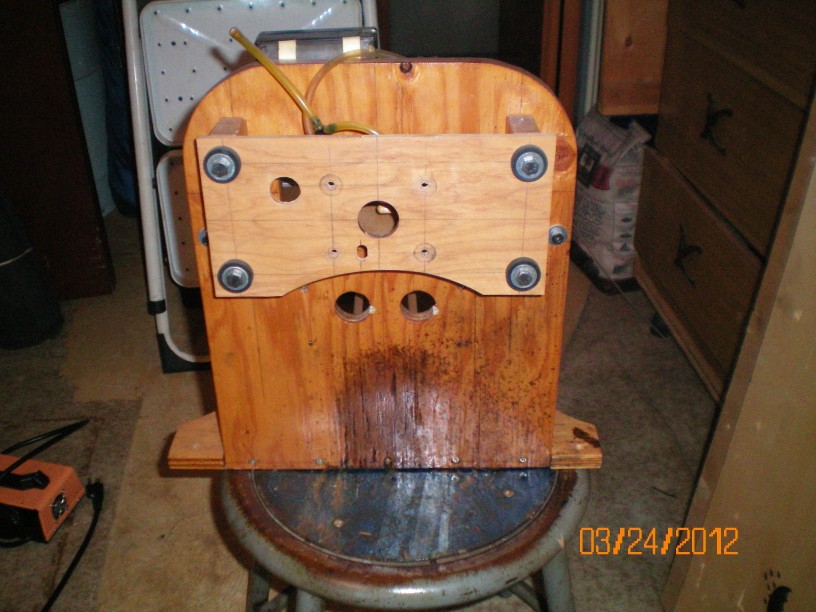

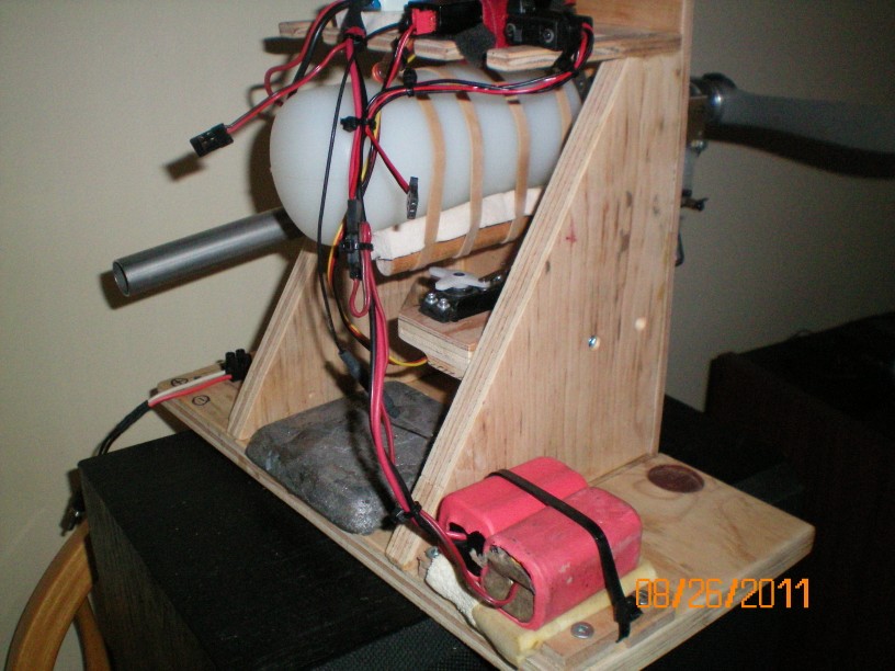

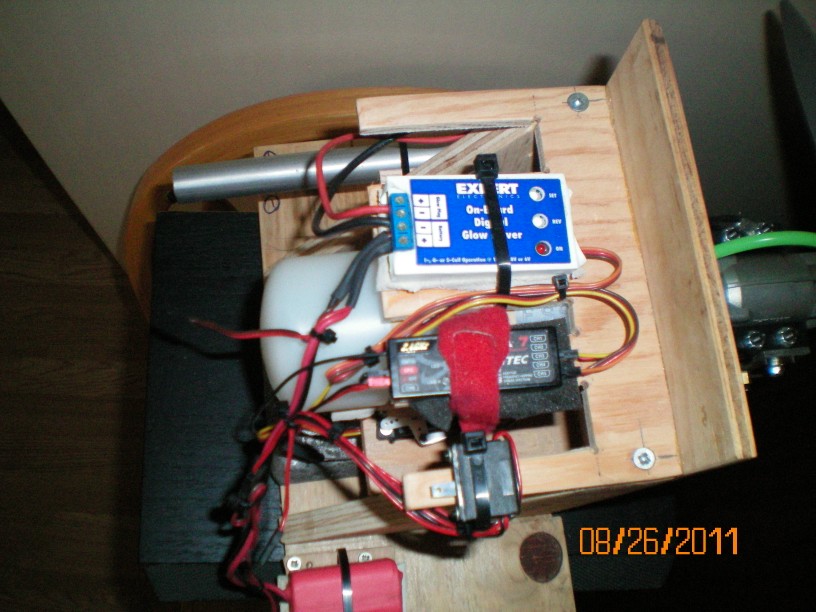

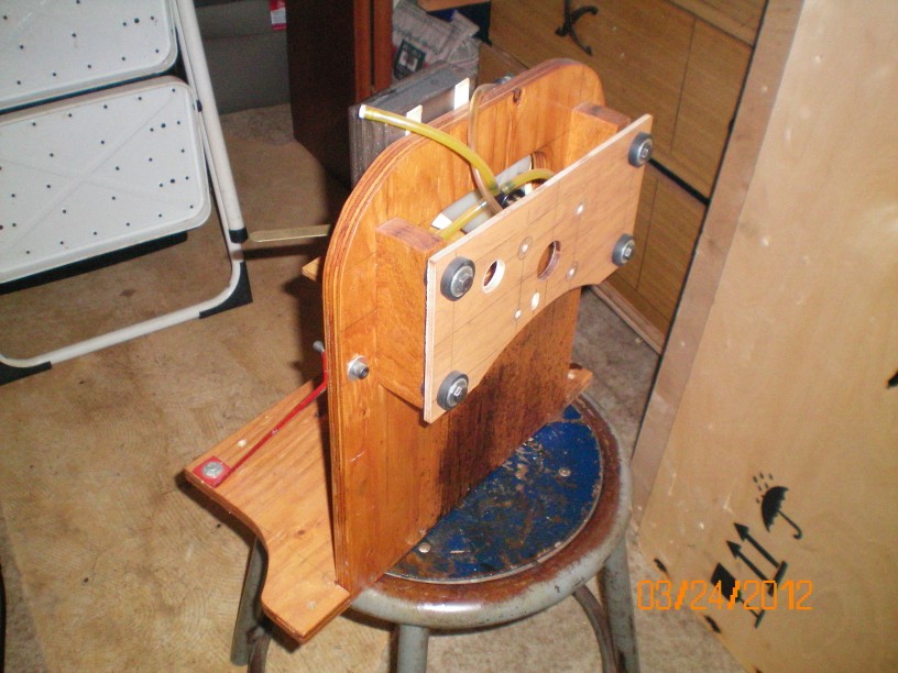

I built this one from materials I had on hand. Red oak and Brazilian Walnut (Ipé), and 3/16" aluminum for the engine clamps. Some 1/4-20 bolts clamp the engine down. Handles whatever size engine I can stick on it. I've had .29 up to .90's on mine.
I used a couple spare servo horns, a few drywall screws, 4-40 threaded rods, and a strip of 3/32" aluminum for a throttle linkage. The fuel tank platform can be raised or lowered.
Took me about an hour to cut all the pieces and another day or so to put a few coats of finish on it. The only engine I cant run on it is my small frame Fox .40. The drop down muffler hits the engine clamp.

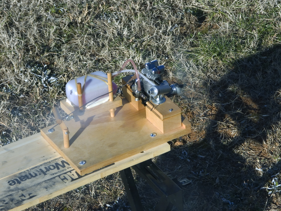

Mine is bolted onto a folding sawhorse. The sawhorse has locking bars to keep it solid. I put the rear locking bar through a concrete block so the whole rig can't tip forward. When I first used, it, without the block, a K&B 4011 tipped it forward toward my crotch. Fortunately, I got it under control without bloodshed. I put the block on before running another engine.

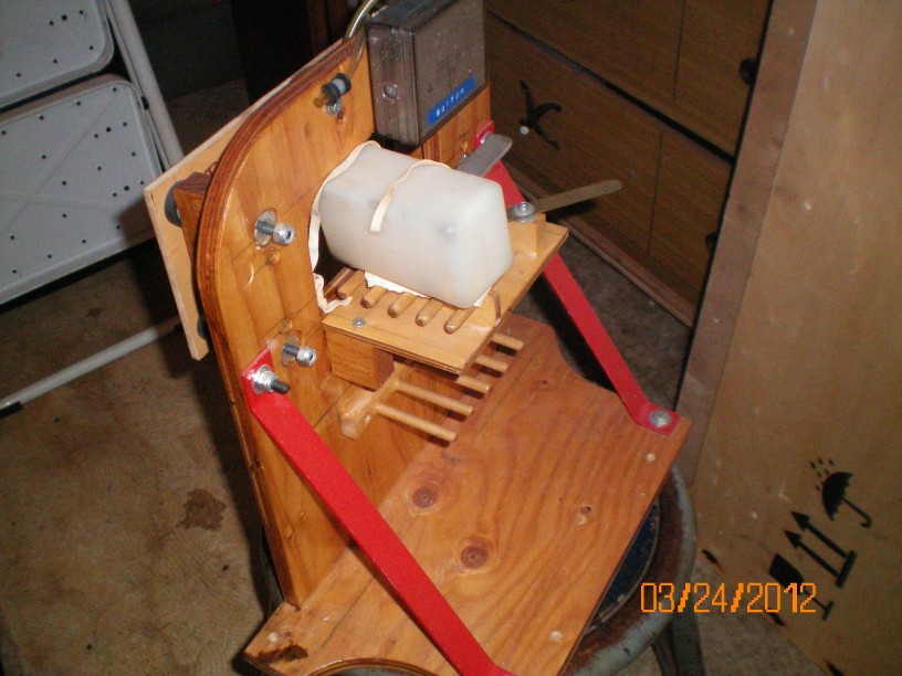

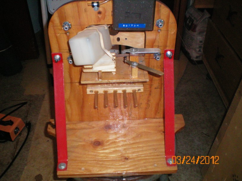

Default RE: Test Stand
I bought one from the guy in FL off of ebay also and it is a very well thought out test stand. I've had .049 though the Super Tigre G4500 on mine.
Here was mine when I got it in the mail.
However now that I have more wood working tools it's easer for me to cut out a custom mount for a engine out of scrap, use it one time and trash it rather than try to clean all the oil off the nice test stand.
The tracks you can get at wood working shops. We use them in wood working to make jigs, slides, fence, and work piece holders for saws.

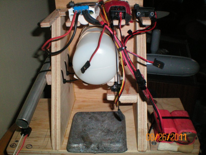

Hi
Here are two test stands , one is for the small two strokes , and the other is for my gasser,s . The one for the gasser,s only has to have a front plate made to change engines .
. The plastic box that you see , ( on the two stroke stand ) is to protect the reciever , if one is needed to program the radio .
Michel
