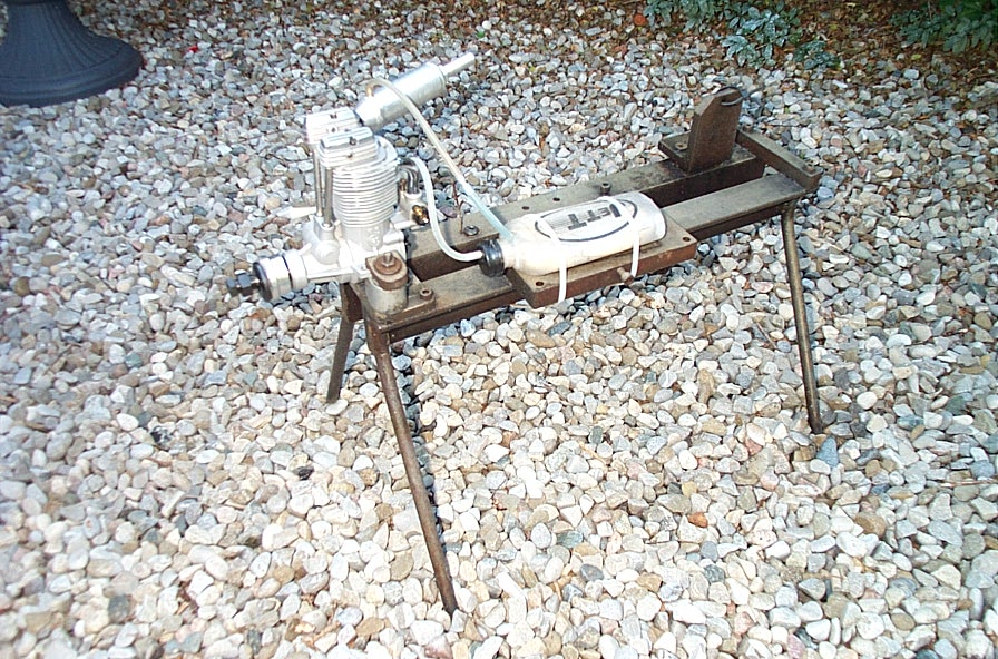

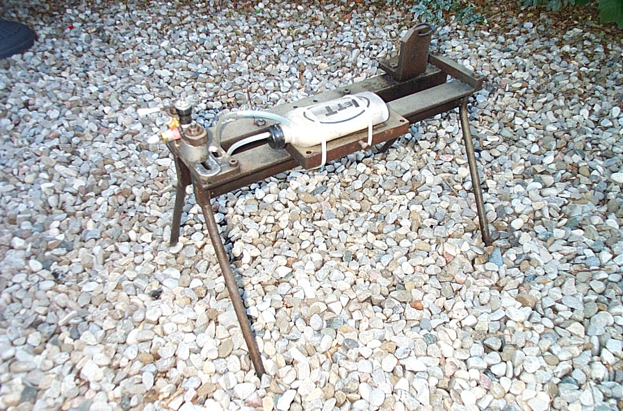

I'm a machinist and a welder..... I built these 2 over the years.
http://www.rcuniverse.com/gallery/ga...m?itemid=83366
http://www.rcuniverse.com/gallery/ga...m?itemid=83343

Those are some pretty nice engine test stands.
I like the idea of using the aluminum or steel block for checking out the heli-shafts with.

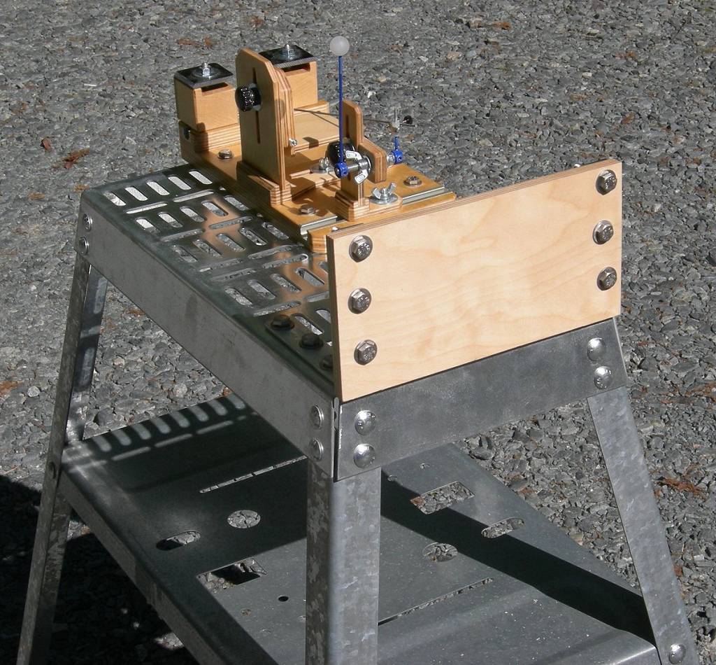

OK here is my new test stand.
The stand I got turned out to be more heavy duty than I had thought, which was nice!
From the pics on the site I got it from, it looked like just a flimsy, rusty old 28 ga. sheet metal stand.
Also the pics on the site made it look like the stand had rust on it. Turns out the stand is fully galvanized and rust free. No need for paint!
The stand is constructed out of 14 ga. sheet metal. The stand was made for mounting bench top power tools.
I weighed the stand and it came out to 25 pounds. This means I can break in motors under 4 HP and not worry about having to tie the stand down.
For 4 HP and over engines I'm thinking about digging a hole and placing an eye bolt welded to a metal frame in the hole then filling the hole in with concrete. I can then place the test stand directly over the eye bolt and run a twin hooked ratchet strap from the stand's frame to the eye bolt and ratchet the stand to the ground with 200 pounds of force.
One nice thing about this stand was that it had a mesh of bolting holes on the top. I easily bolted my old break in stand to one side for quick bolt downs of glow engines.
The other side has a 10x5 wood plate for mounting large engines.
I'm also thinking of making a universal 4x4 stand off plate for the 5x10 plate that will take electric and other engine mounts like a side mounted glow engine with a Pitts muffler.
This little $25 stand turned out to be well worth the 130 mile trip I had to take to get it. I wouldn't have bought it but the stand was located next to a huge outlet mall that my wife likes to shop at. I told my wife I was going to take her shopping at the outlet mall. Then later I told her I had to stop by a guy's house on the way there to pick up something.

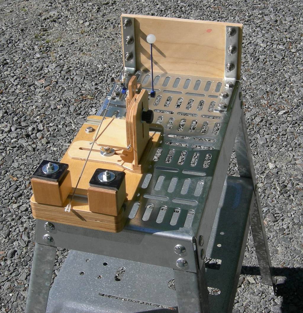

Here's my test stand. It works with all my Saito's from .40 to 1.80. I originally had it clamped to a workmate type sawhorse and it almost flew away when I throttled up my 1.80, so I got some 2" square tube that fit into my receiver hitch on my truck and welded a 1/4" plate to it. Now I bolt the stand to that and it slides into the hitch. It's about 4' long so it's clear of the tailgate.

Love it!
Nice sliding system you have there for thrust readings.

That is a wickedly cool test stand. I like how you setup the pillow block bearings so you can measure thrust too.

Like most projects, it's a work in progress. I'm thinking of modifying thetruck mount with a hinge and a 90 degree stop so I can go vertical with the engine running on the stand.
