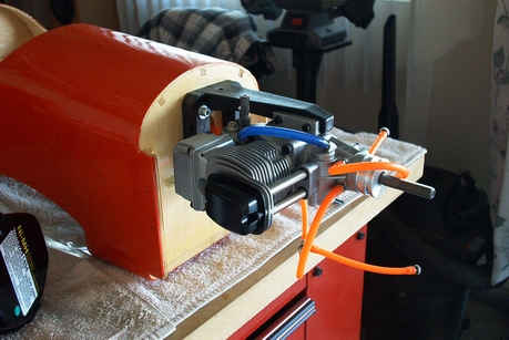

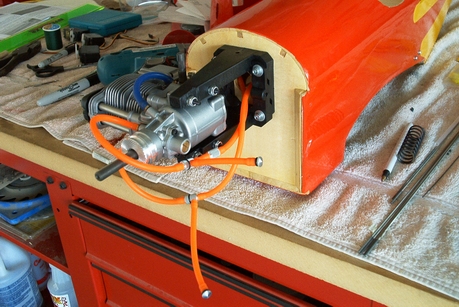

Richard, and others,
I would like to thank the forum and the people who take the time to post answers to help. I used it with my latest project.
Thanks a bunch!!!!
Dennis

Dennis, a photo is truly worth a thousand words. I'm looking at your tee/dot installation, and find two things to comment on.
The first is that on your pressure line, coming off the left nipple, your tee appears to be inserted between the nipple and the check valve. You need to move the tee to the tank side of the check valve, so when you fill your tank the vent line will be open to the atmosphere rather than being blocked by the closed side of the check valve; also when you finish your flight, open the dot on the pressure line to relieve the pressure in the tank. If you don't, when you open the fuel line dot, you'll get a strong squirt of fuel coming at you under pressure.
Second, I don't see a fuel filter on your fuel line, connecting to the right nipple. Maybe there is a filter installed behind the firewall, but if so that filter is also on the wrong side of the tee. If you don't have a filter at all, you will have trouble for sure, probably sooner rather than later. The connections should be from right nipple a piece of tubing to the filter, then from filter to tee, then from tee one line to fuel dot and other to tank clunk line. (Right & left looking from behind the engine.)
Finally, there's nothing wrong with side-mounting your YS, except that it will improve your lateral balance to mount it inverted. With the integral pump, the YS fuels up, starts and runs inverted with no problems that I've ever encountered. Disadvantages though are it's sometimes a pain getting the glow igniter onto and off of the plug (unless you install remote glow connector); and if you nose over on occasion the air intake is exposed to dirt or debris being kicked up. YS or somebody ought to come up with an air filter to cover the intake.
Just wanna be helpful.

majortom-RCU is correct, you want the tee on the pressure line to be between the check valve and the tank. Otherwise, you can never relieve pressure from the tank. It is also a great idea to mount a fuel filter in the pressure line between the engine and the check valve to prevent crud from building up inside the check valve. I see that both of your tee's have built in fuel filter, so you might need to switch to a plain tee without filter after the check valve and install a fuel filter before the check valve. It is also a good idea to color code the fuel lines to avoid confusion. Look at my picture above and you will see that the pressure line is red and the feed line is blue. It is impossible to get the two fuel lines mixed up while fueling or venting.
