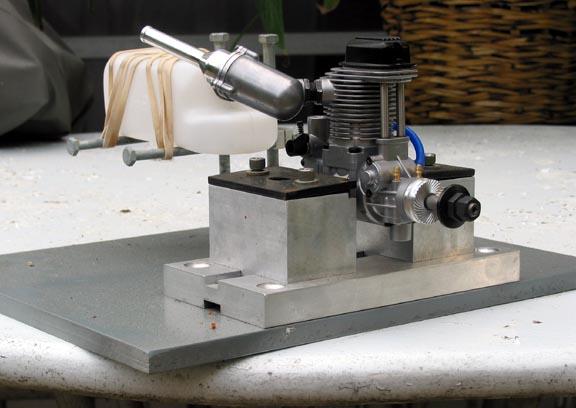

One of our stands. Milled from 7075 aluminum.

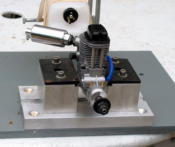

Another view .Hobbsy ,this is the muffler we will be sending to you. We haven't forgotten.

This is a view of the retainer roll pin. There is one on each side. It is placed to prevent a loose clamp from allowing the engine to slip from the stand easily. The pin fits into a clearance hole in the clamp plate and is a drive fit in the stand block.

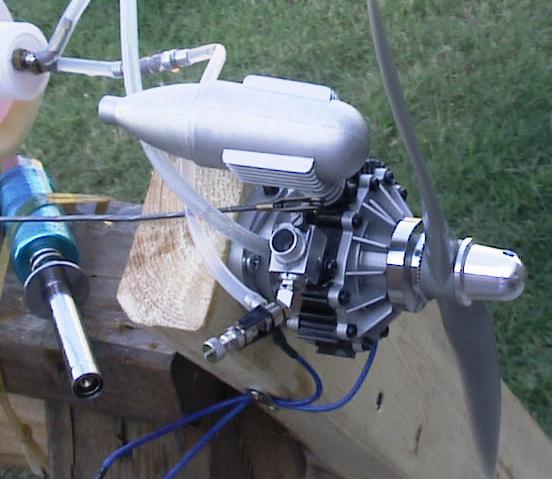

Steven, I genuinely believe the best engine stand is a scrap pile of 2x lumber. I just helped a friend of mine run in an OS Wankel rotary - WOW, what a jewel of an engine!!! It took us probably 25 minutes to improvise the setup.
Let's see a commercial engine stand do that.

Here's another look. We had to hook up a remote glow system because of the location of the plug.
