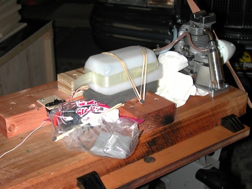

I kind-a just threw this together:
1) Old Black and Decker workmate
2) Scrap poplar 8/4 x 12 lumber end
3) Scrap 2x4's and plywood and drywall screws
4) Old wideband radio parts with S48 servo
5) Scrap wire and pins for pushrod.
6) Large engine test stand mount.
7) Dubro 16oz tank
8) A few screws and rubber bands to hold the tank and radio bag.

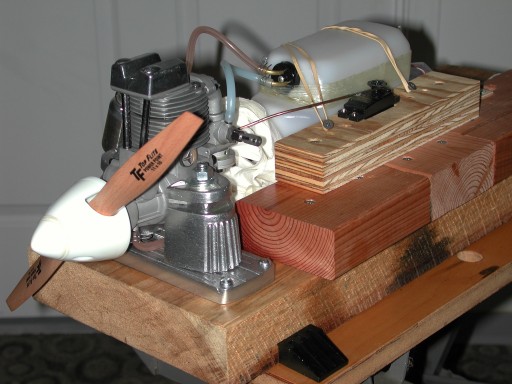

Old 05-06-2002 | 02:48 AM
bgi
My Feedback: (7)
Posts: 907
From: Duluth, GA
Default rear view
with radio components in the ziplock bag.
I have used this with a K&B .61 (screamer!), Saito 180 (tied the workmate to a tree and glad I did!), and last the TT 91S seen in the picture. The cool part is: To accomodate a new engine, I just remove the screws holding down the plywood servo mount, shift it to the proper position, and screw it back down onto the 2x4. I use varying thicknesses of foam to adjust the tank height.

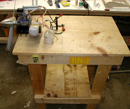

Default Great test stand:
I made a nice test stand from 2x4's, and bought a PSP adjustable test mount, and came up with a test stand I like very much.
The only thing I need to do to it now is to modify it to measure engine thrust. That will take a little planning but should be easy.

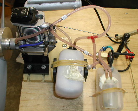

Old 05-06-2002 | 03:50 AM
Traxxas_Tech's Avatar
My Feedback: (22)
Posts: 753
From: Texas TX
Default plans for engine test stand
Heres a close up of the nice machined aluminum PSP mount.
Good luck with your test stand. Coulter

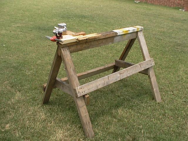

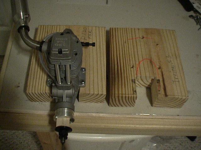

Don't know why you'd need CAD drawings. I've always improvised out of 2x4s and 2x6s. I used a modular system, with a simple cutout for each specific engine. They always turn out to be sturdier than any commercial or "adjustable" system.

Old 05-08-2002 | 02:48 AM
Volfy's Avatar
My Feedback: (23)
Posts: 3,227
From: Houston, TX
Here are a couple of engine module blocks.

Old 05-08-2002 | 02:53 AM
Volfy's Avatar
My Feedback: (23)
Posts: 3,227
From: Houston, TX
Everything is mounted on my all purpose sawhorse. I can setup and tear down in 5 mins.
Best part is that my cost is exactly $0. All the pieces of wood are salvaged from scrap piles at home building jobsites in my subdivision when I go walk my dog.
