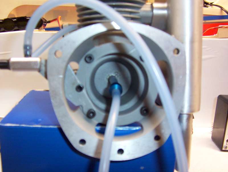

Thanks. I checked it out at Tower, looks good. One question: It mentions tapping into the crankcase, but not where. The backplate?

Yeah Frank, you usually tap right in the center of the backplate, making sure the fitting is flush on the inside. Other locations can be thru the mt. lug (don't think I'd do it that way) or use a special backplate (hollow) bolt usually in the upper left bolt hole.

Just like this.
