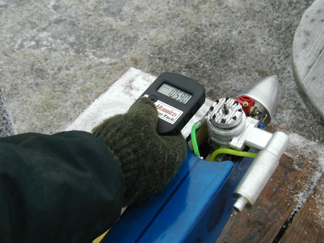

I haven't weighed the plane yet but I did go to the field today to run the engine again, using Byrons YS 20/20 and a APC 14x4 standard chord prop, it turned 12600 running rich. I then put a APC 14x4w and it turned 10580 running rich and peeked at around 11000 +- . The temp today at the field was about 10deg and very foggy. I did fly the plane for the first time (just couldn't wait to get it in the air) everything went good but it had allot of ice on the plane when I landed so I'll just wait untill tomorrow and try it again...Here are a couple of pics ....(check out the ice on the prop...JW

Have you run the 76L yet? If so, please share your comments. I am getting 9200 rpm with 10% Omega and Zinger Pro 14x4. It has been a great engine for 3D so far.

Those are some very good rpm numbers! It appears that your fuel and prop combination works well with the JETT 76l. I'll switch out my Zinger Pro 14x4 for an APC 14x4w and see if my rpm numbers increase. I think it will because APC props are reported to be more efficient. I can say that I've never had an icing problem here in Texas! Boy, that sure looks coooooooooold.

Tex, If you are running 10% fuel try the APC 13x4w or APC 14x4 Standard chord prop mine was running in the 12600rpm range rich(ys20/20fuel) with the 14x4 std.....I didn't know it was running so fast, but when I tacked it I changed to the 14x4w...after a few more tanks I'll lean it out some more ....I didn't take pics of the tail feathers but there was allot of ice on the leading edge...... JW

today was allot nicer day at the field the sun was out and the temp was around 20deg ...I changed to a APC 13x4w and it put it right on the recommended rpm of 11500 ...I haven't peeked the engine yet but here is a pic of the tac...I'll go back to the 14x4w as soon as the engine has used a couple of more tanks. Then I'll peek it ....JW
