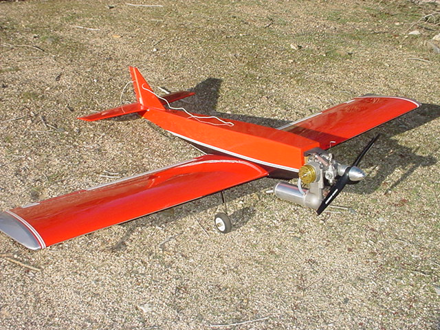

i have a very good running GMS 25 but the only problem i have is it will not shut down on closed idle unless i block off the exhaust . i have set the venturi to totally closed and this engine will idle for as long as possible at a very low idle rpm but will not stop. any ideas guys ?
#559
My Feedback: (21)
....most likely the carb is not down tight on the o-ring, and it has
an air leak there. This is common on the Tower engines as well.
Loosen the cinch bolt and press or tap the carb down tight until
the o-ring is compressed and sealing properly. Then snug the
cinch bolt back up.
FBD. [sm=teeth_smile.gif]

Typically when an engine does not shut off at idle, you have an air leak. This could be either at the carburettor base or the back plate.
If you can not seal the engine by tightening screws or replacing the carburettor "O" ring, you will have to smear a light amount of RTV (or other silicone high temperature sealant available from automotive stores) on the mating surfaces of the carburettor "O" ring, carburettor mounting base or the back plate, reinstall the components and let sit overnight.

You forgot to mention the most obvious leaks... Between the carburettor body and the carburettor barrel, which rotates within it.
If the carburettor parts are machined at the extremes of tolerance (the barrel is the smallest acceptable diameter and the carburettor body cavity is the largest acceptable diameter), a leak significant enough to prevent engine shutdown could result.
The other place is between the draw-bar/pinch-bolt and the engine's crankcase.
Both leaks can easily be overcome, with a small smear of silicon vacuum grease (that will virtually never wash off).

My Feedback: (21)
....yep, I must say my .47 is running absolutly perfectly. The restricted
fuel inlet being the key. Of course, like in the case of the Tower engines,
the carb must seal against the o-ring....or the engine will always be
problematic, with the air leak.
The problem with the Tower .75 was mainly failing to shut off, even with
the carb completely closed. I bought one of the the very first Tower 75's.
When I installed the carb, it was so tight in the case it would not go all the
way in with hand pressure. I looked carefully after I pressed it down as far
as I could by hand, and I could see that the o-ring wasn't seated. I made
sure the cinch bolt was loose, then I put a small block of hardwood over
the top of the carb and gave it a sharp little rap. This seated the carb, and
I could see that the o-ring was squashed and sealing properly.
I never had the shut down problem because of the carb air leak.
Just like with any engine, the owner should go over all the bolts and screws
to insure their proper torque. Too many times, and inexperienced enthusiast
will install and begin running an engine without insuring it's proper assembly.
Loose headbolts have caused their fair share of deadsticks.
All in all, I would recommend the .47 GMS to anyone. I think I paid $65.00
for mine. It turns the 9-7 MAS prop at 16,000 even, and really hauls the
sport Quickie 500 plane.
FBD.

FBD - Thats a nice looking quickie. I bet it hauls rear-end.
