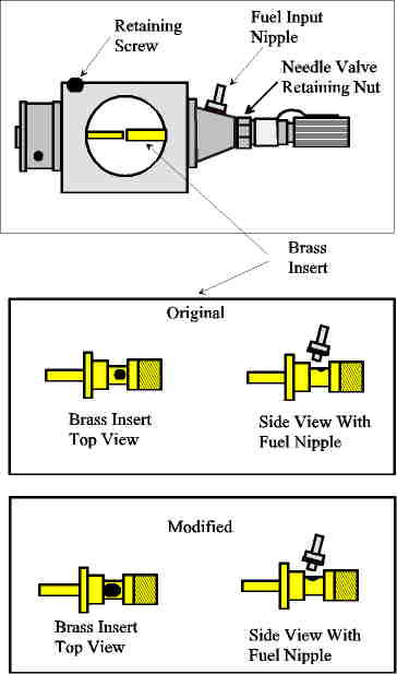

Hey guy's, go back to entry 109. My theory on the hole missalignment appears to be correct. We had temperatures today of 47 degree's F, so off to the field I went. With the warmer temperatures, the engine ran like a top. Transitions were snappy, in fact, that may be an understatement. Due to ground clearance, I could only run my APC 11X3. It turned it consistantly at 15,700 and at times saw as high as 16,200 rpm. In fact, on my second flight, I blew the element on the A3 glow plug. I put another plug in, and was back off to the races. The regular summer crowd was at the field, except for the engines owner. No one could believe it was the same engine, as before I replaced the spray bar, you were lucky to get the engine off the ground. Fortunately my witnesses will vouch for its incredible performance. I am confident that if everyone gets a new carb body with the hole in the spray bar, their problems will go away. I must add, that the engine was very easy to set. No putzing was required!
I am dissappointed, however, that MECOA has neglected to return my e-mail as to our issues.
Andy

I went back and read 109, and I understand your analysis led you to believe fuel turbulance at the brass intake hole may have been the problem.
Your last post said to order a new brass insert to solve the problem. I'm not quite sure why the new brass insert will fix the problem.
Originally I stated I drilled both the intake and exhaust nipple and the brass insert to get mine working. I suspect it was the drilling of the brass insert hole larger was the fix for yours, but I'm not quite sure. Can you explain what you think the fix is?

Unfortunately, to get the brass insert, you have to get the whole carb body. Fortunately that is only 8 or $9.00. I put the brass insert (spray bar) from my good engine into the carb of the engine that was not running right. When I first tested it like this, it would not transition well in vertical flight. I had wondered if it was due to the below freezing temperatures, as a friend with a new O.S. .46 AX was having the same problem in the cold. Since in full throttle, vertical flight, the engine ran well, the only way I would know if the difficulty in a hover was a real problem, was to fly in temperatures above freezing. The 47 degree weather was perfect for that, and it proved the spray bar to be the correct fix.
No drilling was done on this spray bar at all. The hole was just spaced further away from the needle valve. I believe I listed the rough distance from the hole to the shoulder of the insert in another entry, but in simplest terms, it was more centered on the nipple. Looking at the port where the nipple screws in, the entire whole in the insert can be seen, rather than just the edge. The undercut is irrelevant. While it is helpful at lower rpm, at higher RPM, the flow is so fast, it can't make that sharp turn, from the end of the nipple to the hole in the insert, without turbulance impeading the flow. I believe that the fuel may not be entering the spray bar on the taper of the needle either, though I haven't tried to measure that. If the fuel is entering on the flat of the needle, or even on the transition from the flat of the needle to the taper, I believe the adjustments would be very touchy, if not impossible.
I hope I cleared that up, if not, let me know and I will try to write it another way.

You did a great job of explaining it, thanks. We may have done the same thing when we drilled out the brass insert, and this centering the hole.
Thanks for all your help.

Hi,
I haven't seen any responses for a while so I'm guessing we've narrowed the problem down to fuel draw at the carburettor input. I'll try and summarize what we have found in this post.
The problem seems to be fuel turbulance when fuel leaves the fuel intake nipple and takes a sharp turn when it enters the needle valve area (see drawing attached). This can create foaming, and in worst cases, a fuel air lock. This makes carburettor adustment difficult and may even cause the engine to quit while in flight. To give credit where credit is due, this problem was identified by another modler, Andy, in an earlier post and you should read it.
We have tried many things to fix this, such as, more muffler pressure, enlargening fuel/exhaust nipples and drilling the carburettor brass insert. Drilling the hole larger in the brass insert seems to have done the trick, I have just drilled three and all work well after the modification. Drilling the nipples does not seem to affect the performance, but doesn't hurt either.
I'm going to try and upload a picture to help those who have not done the modification yet. The modification can be done with the brass insert in place (although you have to be very careful not to damage the nipple threads) or by taking out the brass insert and drilling (preferred).
The hole in the brass insert should be as close as possible to the "shoulder" of the brass insert and directly under the fuel intake nipple.
If you chose to try this modification, please make sure you do not have a carburettor air leak (where carburettor enters engine body) or an air leak at the engine back plate. If you do, you must seal first. Seal with Ultra Copper Hi-Temp RTV by Permatex (available from auto motive stores) or replace "O" rings as necessary. Testing for air leaks is described earlier in this thread.
Please be aware that any modification will void your warrantee.
See instructions below and refer to the attached picture for part location. I've included two sets of instructions, one for drilling with brass insert in place and the second to remove brass insert for drilling.
If you chose to drill the brass insert in the carburettor:
1. First remove the needle valve retaining nut, needle valve and the intake fuel nipple to avoid damage to the needle valve. Drill the fuel intake nipple one (or two) size larger.
2. Reinsert the fuel intake nipple and then use it as a drill guide, this will protect the nipple threads.
3. Very carefully drill through the fuel intake nipple and into the brass insert.
3. Remove all brass filings from inside the brass insert and re assemble the carburettor.
If you wish to remove the brass insert to drill (prefered method):
1. Remove the intake fuel nipple
2. Remove the needle valve assembly by taking off the needle valve retaining nut retaining nut to avoid damage to the needle valve.
3. Remove the retaining screw
4. Remove throttle barrel, be careful, there is a spring behind it. Note: small end of spring goes into carburettor first.
5. Using a hardwood dowel or brass puch, carefully tap the threaded end of the brass insert until the brass insert comes out. Note: be careful not to damage the threads.
6. Drill the hole into the brass insert at a slight angle towards the carburettor throat (same angle as fuel intake nipple).
7. Clean out all brass filing out of brass insert and remove any drill burrs.
8. VERY IMPORTANT! Reinstall brass insert so the enlarged drill hole is directly underneath fuel intake nipple. To reinstall brass insert, you will need a hollow punch and a backup block with a hole (preferably made out of a hardwood block). Set the brass insert in place so the newly drilled hole will line up under the carburettor nipple. Put the carburettor over the hole in the wooden back up block and gently tap the brass insert in place using the hollow punch.
9. Reassemble carburettor.
After the above, you should adjust your engine as described in earlier posts.
I have just done this with three engines and they all work well.
If anyone else has any input, please let us know.
