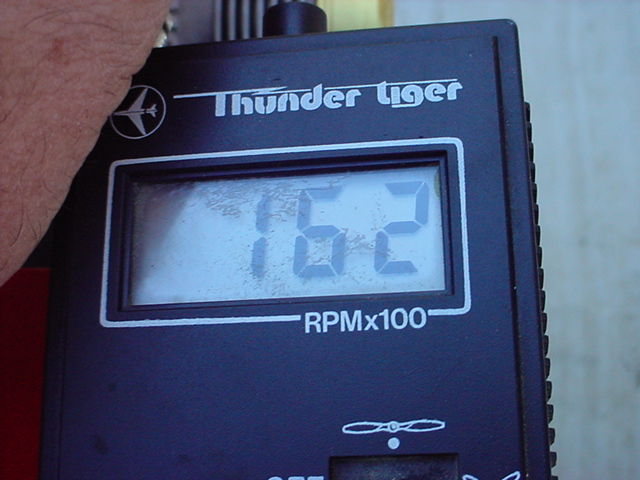

Well, I wound mine up today....I pre-heated the engine to remove the pinch.
I had also pre-oiled the piston with some straight castor. I ran it for three
shorts runs, a few minutes each....full throttle, working the needle in and
out between peak and rich.
On the third run I wound it up....I had seen 16,000 even, but this time I
wound it up, and quickly took a pic, so I could richen it back up. I was
cranking 16, 200 as you can see, a real screamer. I tached it at my rich
setting (cool running) and it was turning 15.5 to 15.6.
I had to open the low speed 1/4 turn, it was bogging coming up off idle,
now the transition is crisp. I am very pleased with the way it ran, and spun up.
Not bad for $65.00 !!!
FBD.

Hi FlyBoyDave,
Great pictures! I'm glad that another GMS .47 is "off the shelf"!
If opening the low speed needle a little (richer) stopped the bogging during transition, it is the same as I had experienced with another GMS .47 engine. Previously, I would have thought it would have to be turned in a little (leaner).
Thanks for the report, just for your information, I'll be out of town next week, and out of touch - so I won't be able to respond to any emails.
I like planes that are fast, "goove" well, and are able to slow down for landings. I may look at one like yours. Let me know how it flys.
