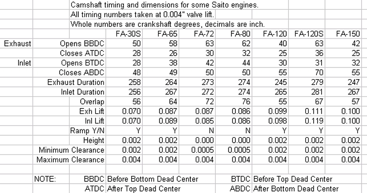

The first time I checked the valve timing on my old Saito 150 I was amazed.
Old 12-22-2004 | 01:03 PM
Posts: 20,205
Received 20 Likes on 15 Posts
From: Mary Esther, Florida, FL
Default RE: To modify a 4stroke cam
All:
I've posted this before, but I don't thnk it will be out of line to add it here.
These are specs for some Saitos I've checked. Hobbsy's little FA-30 is in here too.
The mildest cam timing here, if in your street auto, would make it a fire breather.
Bill.
