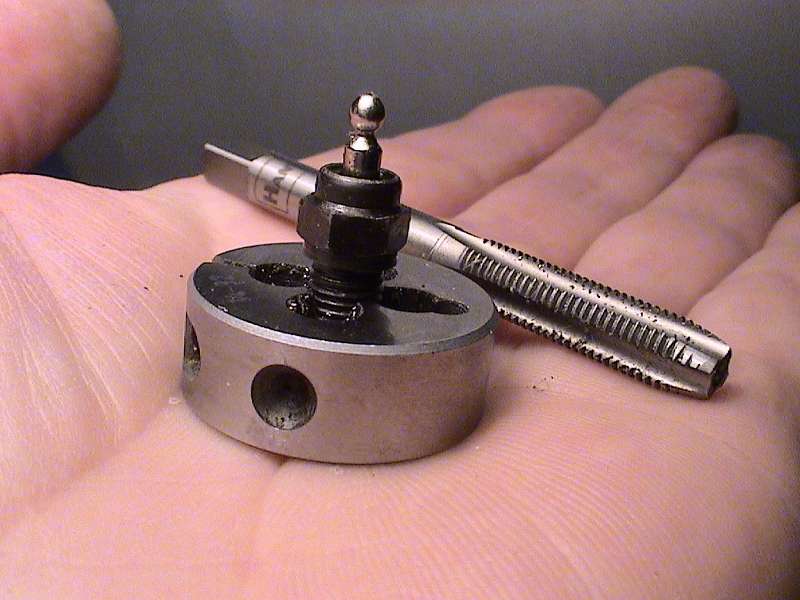

Old 01-29-2005 | 12:04 PM
Posts: 7,816
Received 10 Likes on 10 Posts
From: Upplands Vasby, SWEDEN
Default RE: Glow Plug thread difference?
Hi!
This is due to different manufacturing tolerances!
Therefore I always use a 1/4-32 tap and die to really be sure that I don't destroy the treads in the head.
Regards!
Jan K
Sweden

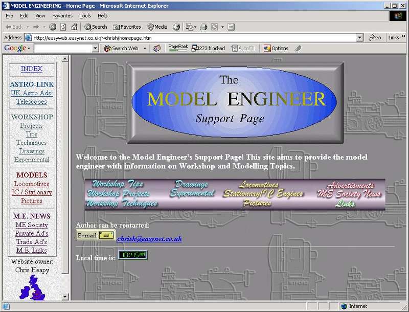

ORIGINAL: Motorboy
See in article about make own tap: http://easyweb.easynet.co.uk/~chrish/homepage.htm see after the list: 7. Make a tap and die from carbon steel.
Jens Eirik
Hmm that link dont work no more. darn !
Old 01-30-2005 | 05:47 AM
DarZeelon's Avatar
Joined: Apr 2003
Posts: 8,913
Received 6 Likes on 6 Posts
From: Rosh-HaAyin, ISRAEL
KnarF,
Yes it does.
Check your PC's settings...
