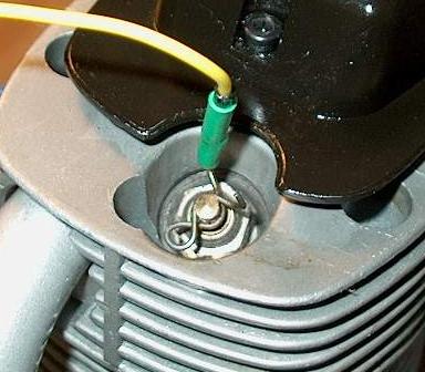

does anyone have a good solution for a good, solid connection for remote glow igniters on YS engines, especially on a soft mount? Mine get shaken to bits and can't stay on but a couple flights.
Tried the OS, Sullivan and DuBro ones, but without much success.
Any ideas? Thanks much in advance.
I've almost resorted to soldering the wire to the plug!

Old 09-22-2002 | 04:17 AM
can773's Avatar
Posts: 2,286
From: Calgary, AB, CANADA
Default durable remote glow igniter for YS
See attached photo, works like a charm
