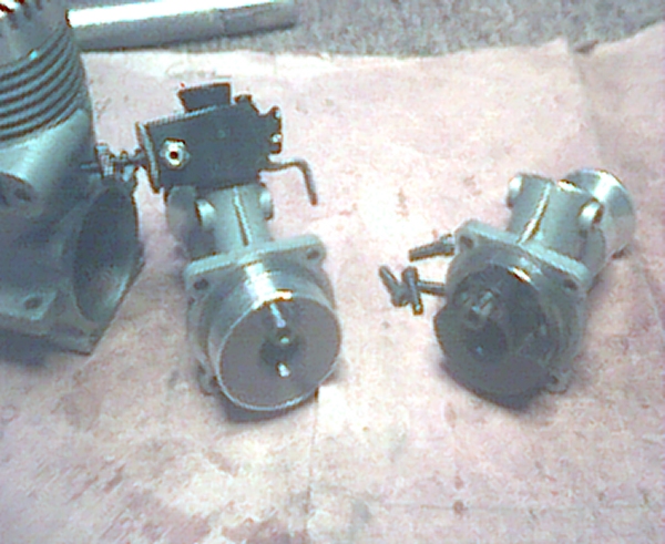

Here's an example of what FBD was talking about, but this is a factory part.
On the right in the picture is a normal "Sport" crank shaft, with the web milled for balance. The crank on the left is from the "Q40" engine, instead of the open milling it has slots milled from the edges, then an aluminum ring is shrunk on the outside diameter to keep the free volume of the crank case as small as possible.
Bill.

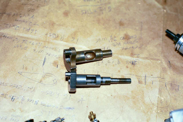

I really think you were asking about the inlet port rather than the stuffing of the case.
Here are two more cranks, K&B again. The lower crank is a standard port, the upper one has a "Flowed" port. Many use JB Weld or PC-7 to fill the forward part of the port, allowing it to be shaped for better air flow.

I've seen several engines with the induction port ball milled (I think that's the way they do it?)
The Magnum .52 I have, and the 2 Evo's, and the as mentioned AX...
Several of my r/c car engines have it too...
I did a K&B 40 and .61 years ago with JB weld and it hasn't broken loose (yet anyway) maybe because of careful prep.
I roughened the area w/ a Dremel grindstone, after a thorough cleaning w/ acetone. I put the JB weld in and set the crank at an angle to cure. Then I baked it in a toaster oven at about 200* for awhile, then after it cooled, I went in w/ the trusty Dremel and put the radius in there...
