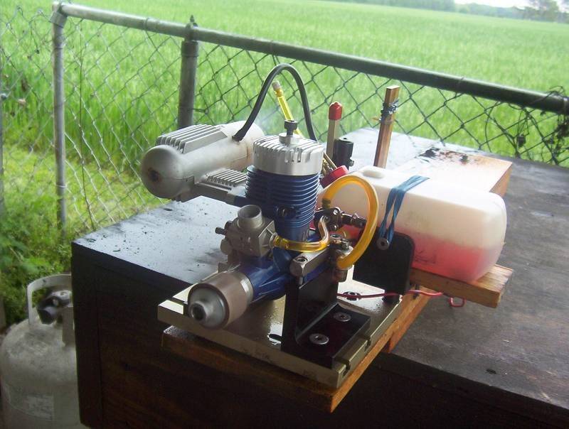

Here is a thread I started years ago called 50 Diesel Mostly: Diesel .50s (mostly) as can clearly be seen, some were better conversions than others
The OS LA 65 below turned a Bolly Clubman 13.5 x 8 at 9,300, this head was made by A. J. Coholic in Canada

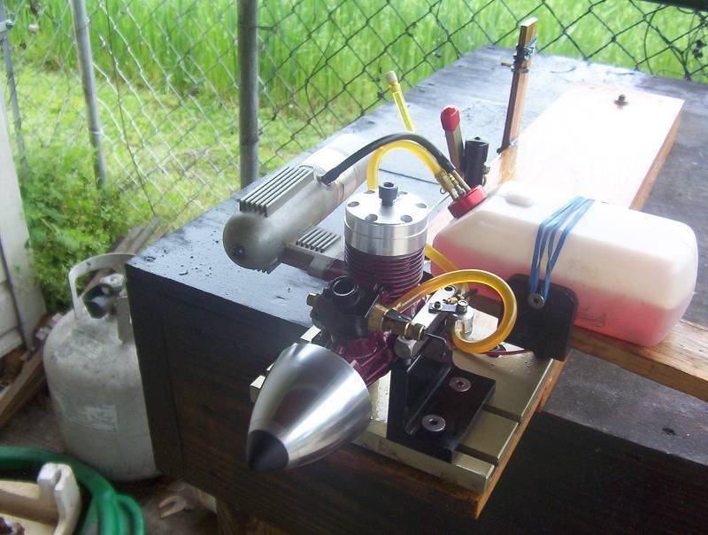

The PAW 60 turned the Bolly Clubman 13.5 x 8 at 7,500

A surprisingly powerful Diesel conversion, an OS LA 65
Disappointing Diesel, a PAW 60

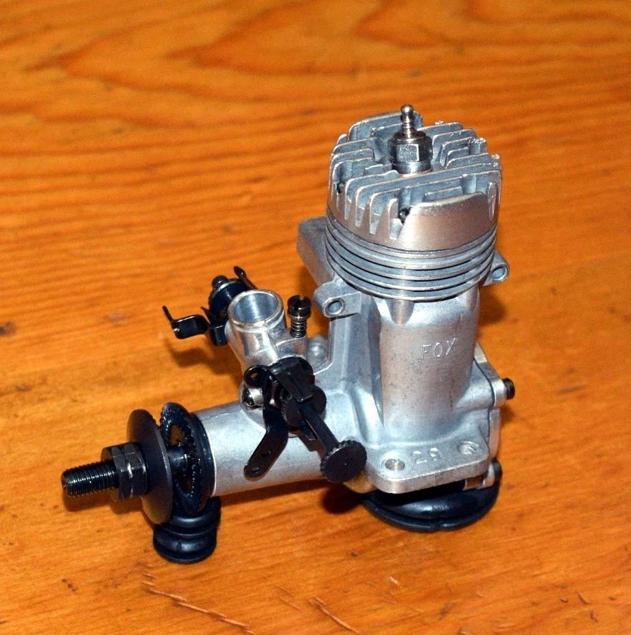

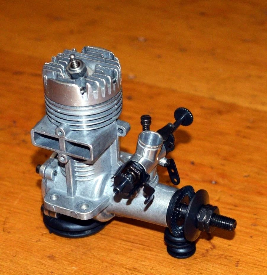

Picked this one up recently in NOS condition, a Fox .29 R/C cross scavenge engine.
Recent EBay purchase, a Fox .29 R/C - right side view.
Recent EBay purchase, a Fox .29 R/C - left side view.

I acquired a Fox .29 RC just like the one pictured. No matter what I did, I could not get it to run. It would start, running very rough and unable to throttle up, while spitting fuel out of the carburetor, then quit.
After trying many, many things, I finally took the engine apart and discovered the sleeve had been installed 180 degrees wrong... exhaust ports on intake, and visa versa!
The engine appeared to have never been run, so it is a mystery to me as to HOW this might have happened? Since Fox test ran all engines at the factory, again I wondered HOW..?
Anyway, after correctly positioning the cylinder sleeve, the engine started and ran very well.

Interesting find. A bit before my time so went looking for info.: These were apparently sold through the 60s - 70s. The reports show a pretty well developed carb for that gen.
Any manual? From what I found it ran a max up to 5% nitro, so would likely avoid anything higher.
Also, looks pre-Schnuerle. With the offset plug would think that is the case.
Also, with those bosses and lack of exhaust baffle it appears there should be a muffler option. Would be interested in what that looked like. Found pics of one with a home made dual stack, but no muffler yet.

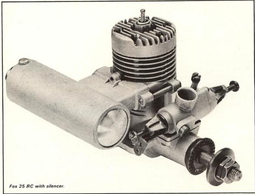

This .29 R/C has the newer muffler mount lugs on each side of the exhaust port toward the rear. Fox made this change as the above and below mounting system in the middle of the exhaust port was weak, easier to damage the engine in a crash. So this .29 was one of the later ones. This photo for the .25 is probably the muffler that the .29 used:
From Jan-1982 Aeromodeller Magazine, Fox .25 R/C Engine Review by Peter Chinn obtained from https://sceptreflight.com/Model%20En...2025%20RC.html
Sceptre Flight Engine Tests does not have an article on this particular Fox .29. It's carburetor is a little earlier than the MK-X that is on my .25. My guess is the Fox .29 R/C from the 1970's, probably the last of the series. My Fox .25 R/C has the later single piece cast aluminum streamlined shaped muffler.
I don't have a manual for the .29 R/C, else I would scan and share it.
