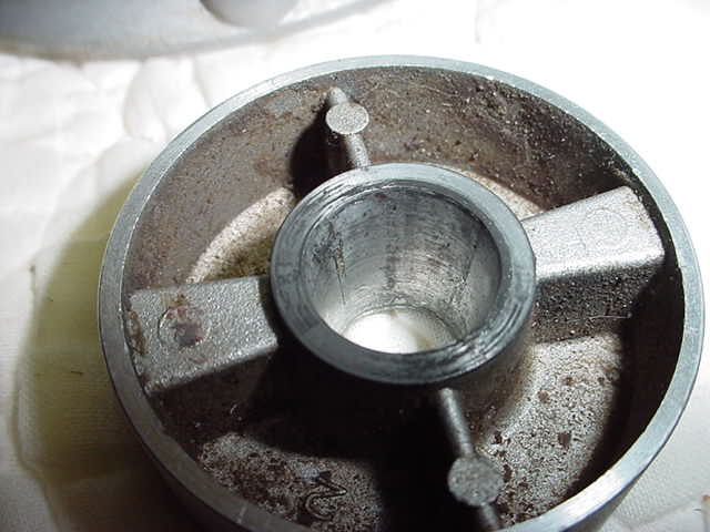

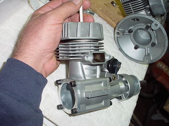

I see what you mean.....If the collar needs to be in
a certain location....you think it would be ''keyed''.
I'm gonna see if I can drill out a glow plug, and make
a TDC guage. I'll use a puller, and get that collar off
and see what the story is.
I'm gonna get to the bottom of this "balance thing".
I have a plan.....
Dave.

#37
Flyboy Dave:Now why do you suppose Super-Tiger did that ? After all these years of trying to keep ahead of their carbs. they did this! I was told of this trick by the fliers in Minneapolis. They swore by it. Sure don`t look like enough difference in two webs to help. Sometimes I think they are pulling my leg,not sure of people that eat that Norwegian fish.I still check my props ,mark heavy blade and put it 180 degrees from piston at top dead center. Works for me! big max 1935
#38
My Feedback: (21)
I don't know why they have the webs in the collar
like that....but they're 180 degs apart, and the
collar is in pretty good balance. I couldn't get it
perfectly on centers (see the prop nut), but got it
pretty good. I did mark the heavy side, and will use
it.
I don't think the heavy webs will make any difference.
Dave.
