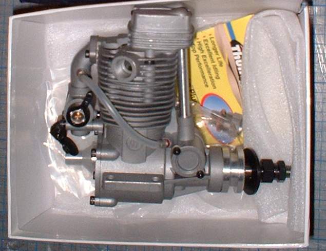

Crank Case Vent
Why?
Any opening in the intake will change the air/fuel mix. Not a good idea. Also, a vent in the intake will not depressurize the crankcase.

Magnum engines are designed like that, and (at least the one I have) runs exceptionally well. However, I suspect this is because it was engineered this way--and all variables were kept to a minimum. However, I have not, nor would I ever, retrofit my other four strokes for this kind of application--simply asking for trouble.

Leave it. Magnums are engineered with that design, and changing it could cause tuning problems. My magnum runs great--until, that is, I beat it up one fine day (landings are better with the wheels down!)
Don't worry, though, as soon as global gets valve covers in, mine will ride again. Good, strong engine. You will like it. It's a steal for the price!
Leave it as is. What most people on here are saying is don't make your engine recycle crankcase exhaust if it wasn't designed to in the first place.

No, I'd leave it connected. If it were from the back of the crank case it would be different, but the way Magnum has done it greatly increases the oil to the cam and tappets.
