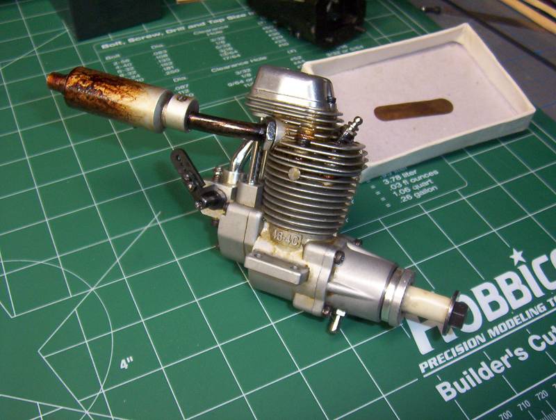

I need some help with my favorite engine, the Enya 53-4c. The engine is about a year old with one and half gallons of fuel thru it. Last month I lost my muffler half inflight. I did not touch any settings before or after I lost the muffler half. Yesterday I installed a new OEM Enya muffler and ran her up on the stand and she was knocking at wide open throttle. I richened it up 500 RPM from max RPM and it was running fine on the club set-up stand but when I throttled up for T/O she was knocking at full throttle. I put here back on the stand richened it up 1000 RPM and it ran rich but fine. Throttle up for take off and it knocked the prop loose on the shaft. Here is my set-up: She is mounted right now on a Spacewalker II inverted with a APC 12-6 prop, Enya #3 plug with Omega caster/synthitic 5%. I was reading my Enya paperwork last night and it recommends 5-10% caster/syn blend and also recomends using a head gasket if the engine knocks with a 12-13 inch prop. Has anyone experienced this ? And what was the fix? Prop down to a 11-6?
Dr. Bellows,
This is strange.
In the first part of your description you wrote about richening from maximum RPM...
As you lean the mixture in a four-stroke engine, running at full throttle, it gradually speeds up, eventually reaching maximum RPM.
As you lean it a bit further, it will start knocking softly and lose RPM. A bit more leaning and it will knock hard, backfire and throw the prop.
If leaning the mixture causes the engine to speed up, it is not the dreaded 'knocking' that you hear.
Knocking only happens if maximum combustion pressure is achieved, as the piston is still rising toward TDC and this will act to slow the piston down and reduce the RPM, even before the knocking becomes hard enough to stop the engine dead.
As I wrote in another thread, the main function of the fuel needles in a glow engine, is to control the ignition advance, since a lean mixture will flash earlier and burn faster than a richer mixture.
Could your engine have a loose valve (too much valve clearance), or could your con-rod have developed excessive looseness at either end? Are the piston bosses not 'egged out'?

I would think your Enya would turn that APC 12x6 no problem in the 10000 RPM range. Are you using a tach. for tuning? Too large of a dia. prop. will produce a knock. Personally, I have never been to keen on Enya plugs. I would first try a OS F plug, check the valve train and take it from there, then try a smaller prop.
One of my OS 120's developed a knock last year that was different from an ignition knock. Turned out to be a bad rear main and one cam bearing was iffy. I concluded it was most likely a bearing problem because the RPM had dropped considerable and it seemed to be running a little warmer.

Here is more info: Upon partial teardown I noticed very weak compression and a lot of blow-by from the crankcase nipple. I dissasembled the engine head and found no bent pushrods or sticking valves, sleeve looks excellent. I pulled out the front housing found the connecting rod in good shape. The timing box was removed and found no striped gears. Hope this helps for you troubleshooters.

This may be unrelated, but I've seen it fool some very good engine people over the years.
Ensure that your battery, or other solid object, is not vibrating and creating the noise that you are hearing. Our ears and our brain can be fooled fairly easily, in this regard. Don't ask.
I would have suspected the upper end of the connecting rod also, if you flew the engine for a while after losing muffler pressure when the muffler came apart. You did say that you checked the connecting rod, so this probably isn't the culprit. Enya's are built really well, and it would surprise me if this were true. But, it's just something else on the check list.
Since you had the engine apart, I assume that you checked for carbon build-up in the cylinder and head assembly. A spec of carbon could be acting as an unwelcome ignition source.
Good luck finding your way out of this dilemma. Please let us know the cause.
