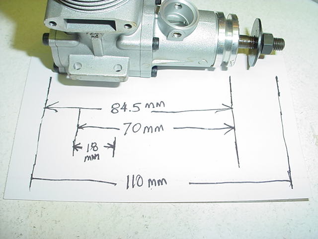

so im getting runum RICH! anyone have the mounting dimensions or a link to some drawings specs ect ( .40 FSR ) for my engine is out for repair and i want to get this mount tapped.
Old 12-08-2005 | 10:36 PM
Flyboy Dave's Avatar
My Feedback: (21)
Posts: 13,864
Received 10 Likes on 10 Posts
From: Pinon Hills, CA
Default RE: os .40 fsr users guide
Here Ya' go....(hope this helps)....[sm=thumbup.gif]
FBD.

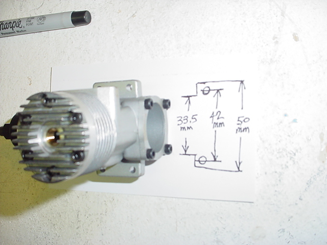

that helps tons can i get the width of the engine @ center of mounting holes? and thanks again this is a big help [sm=RAINFRO.gif]
Old 12-08-2005 | 10:48 PM
Joined: Nov 2005
Posts: 132
From: LusbyMD
also the 18mm is that the holes center or is it the full lenth of the mounting beam
Old 12-08-2005 | 10:54 PM
My Feedback: (21)
Posts: 13,864
The 18mm is the center of the mounting holes, lemme go measure the width.
Old 12-08-2005 | 11:20 PM
My Feedback: (21)
Posts: 13,864
[sm=thumbup.gif]
