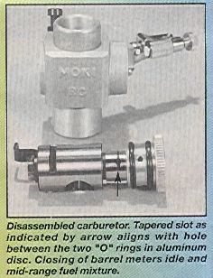

This one has the carb with the big disk on the side to set the idle mixture?
Make sure the marker on the disk is set at the neutral point.

Yes this is the one with the big disk on the side to adjust the idle. I started adjusting that to get it to start and hold an idle. Where is the neutral point? When you say that if there is a piece of lent in the iddle circut do you mean the idle setting or the high speed idle valve?

There is a shaft attached this disc inside the carb. it has a little narrow slit in it. This slit can get a piece of trash in it.
There should be a dot or line on the side of the disk. This should be straight up for the usual setting

Here's a picture of what I was talking about.

So the holes need to be lined up when the throttle is closed?
