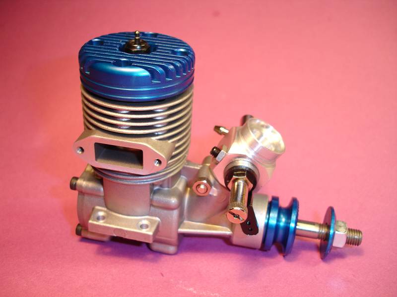

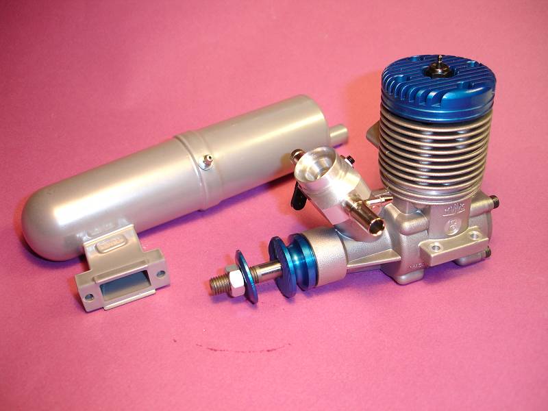

You need a different engine and a clock vise running prop. MVVS have engines with special clock vise running crankshaft (available for all MVVS engines).
Regards!
Jan K
Sweden
