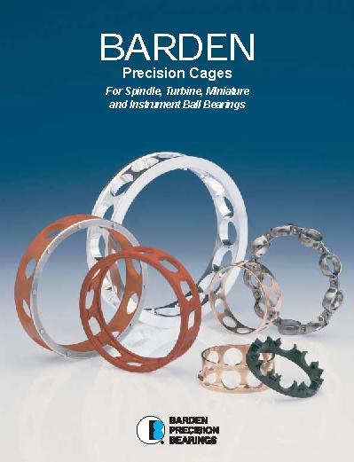

Probably a combo of both, you'll feel it if it is bad enough, but won't if it isn't. Last time I experienced bearing failure, engine was running close to normal, just making a rapid but soft "kunking" sound, no play in the shaft at all. When I took the bearing out, found that the little fingers that sandwich the bearing cages had started to come apart ever so slightly.
Retainer?

Here's a pic of the cage,

Ok, but there was mention of fingers?
