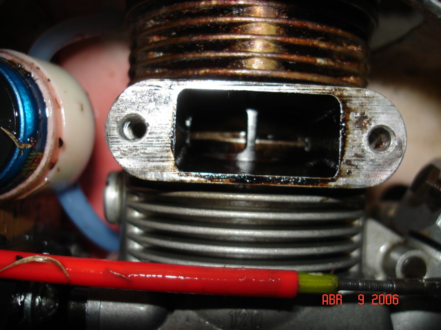

After quite a while I was ble to understand what you meant by your suggestion of checking whther the cylinder sleeve's ports were alligned with the ones of the crankcase.
I dismounted the muffler and saw a couple of rectangles with a space in between which I think it's the right thing to be sawn here.
I am attaching the picture I took and the exploded list webra posted for this engine(see link below) they look like they are ok

I don't have a Webra 1.20 with which to rotate the cylinder sleeve and make a comparison, but in your picture that does look real good (correct).
I'm scratching my head trying to figure out what else could be wrong.

That engine appears to have been run very lean and hot, stuck ring?
Were it my engine, it would be heading for the antifreeze filled hot tub for a clean up.
He did say that it had better compression than the engine that outpowers this one. Strange.

If the cylinder sleeve isn't obviously damaged, I wouldn't replace the sleeve. That is the beauty of ringed engines. Most times, all you need is a new piston ring.
With ABC engines you need to replace both the sleeve (liner) and piston as a unit. Not so with ringed engines, unless there is obvious damage that you can feel with your finger.

I see from the pictures your engine is running a fuel with a high amount of castor oil which is good, but if it was stuck once it will stuck again soon. A good thing you can do is to gently remove the piston ring and make it smaller about 0,1mm, 0,004"inches, on a abrasive paper 200 grit. Put it back as it was before and you are done. I have done this several times on my big supertigres with great result and the ring did not stuck again.

Last night I disasemble the other webra 1.20 I have and the cylinder exhaust ports look exactly the same.
I also will take other recommendations and what I am gonna do is to buy the cylinder sleeve and piston ring.
Since I hope the power will improve I'll switch to a 3 blade propeler.

Since the ring was stuck, the rings will have to seat again before power is restored. I would use a fuel with some castor oil till seated, then use a gallon of synthetic to clean it up a bit, then back to synthetic / castor mix.
