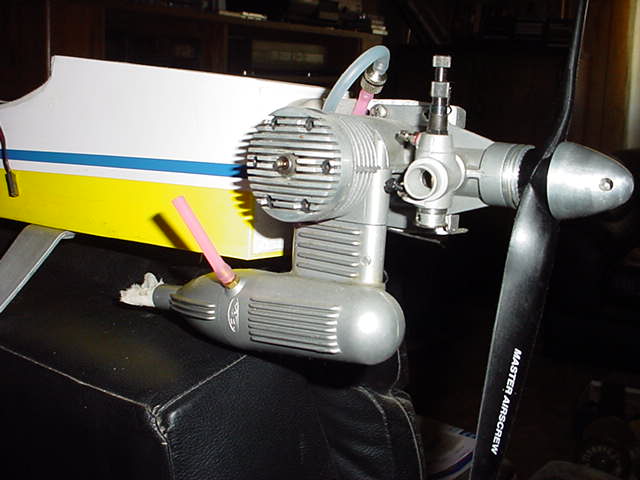

K&B .61 owners,
I just bought a never been flown Carl Goldberg Super Chipmunk that was built 15 years ago with a never been run K&B .61 (6550 model) with a Tatone muffler. I went to my local hobby store and was recommended to use a 12x6 APC prop. Break in involved running on the rich side with 1 tank of 10% castor synth blend and 1 tank of 15% all synthetic. The APC 12x6 flight and wooden 11x7.5 flight were noticably different.
Thank you all for this thread and what it has done for my K&B .61. I was NOT a happy camper until I changed to the wood 11x7.5. I will surely be trying the master air screw brand as well as the APC in that 11x7.5 size if I can find them.

I can't help but trying and comparing the APC 11x7 (they don't make a 7.5) and the MAS 11x7.5 versus the 11x7.5 Zinger.
I'll let everyone know the results as far as RPM's on the ground as soon as I can get a hold of the props.
I might need the ounce or so's extra weight of the APC because my Super Chipmunk was built really light but it's still a teeny bit tail heavy -- I haven't exactly weighed her yet but I'm sure she's no more than 6.5 lbs All Up Weight (soakin' wet)
Have you compared the APC 11x7 to the MAS 11x7.5?
An earlier statement in this thread was: "According to the power and thrust spread sheet I got from Pe Rievers the 11x7 APC at 11,760 rpm takes 1.03 hp, and gives 6.2 pounds thrust. "
The K&B specs say that the .61 is supposed to be 1.3 HP
What do you think of those apples??
Maybe the MAS 11x7.5 prop can produce the difference of 1.03HP and 1.3HP????

TimC,
I thought those numbers were a little "off" seeing as how I was getting readings in the low eleven hundreds with the APC 12x6 on the 1st tank, 90 degree day, running 10% castor/synth before I richened it up and lowered the rpms to high 9's.
K&B 61 owners,
I'm still having trouble getting a low idle - the low end screw is 'out' past the 'level with the barrel" factory setting.
I heard it takes 2 gallons before you can really get the lowest idle and full throttle with no transitionproblems.
I'm excited about the potential that my flying buddies tell me to expect once the engine is broken in.
ACCORDING TO THE DIRECTIONS FROM THE BOX, As I lean out the high end, I should be richening (turning counterclock) the low end -correct??
Are there any tips anyone can give me as far as the time/tankfuls expected before the process is complete? I'm at about 1 gallon of 15% synthetic so far.....

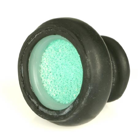

Have you guys ever heard of a Bru-Line fine mesh air filter (BRU-202 from Horizon) to keep the carb "spray" down in the carb?
It sits on, in & around the venturi.
Anyways, could it be that I'm having trouble with the low end (only a reliable 2800 rpm) because of not using a idle bar glow plug?
I'm using a OS#8.
root
I'm using a OS#8.
root

The air cleaner will work fine, and keep a lot of the carb mist off the engine.
You do not need, nor will it help to use an idle bar plug in that engine. Use
a K&B 1L plug in it.
You can seal the exhaust manifold to the engine with some high temp
silicon seal, and that will keep the engine cleaner as well.
FBD.
FBD.
