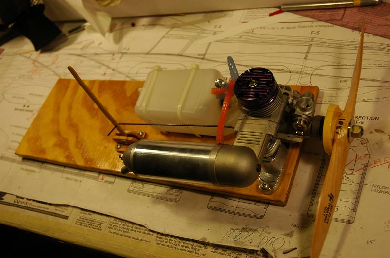

Need to build a test bench to run my K&B. I have a engine stand but it's not mounted to anything. What do you guys have. How do you set up a throttle control and fuel system.

How do you control the throttle?

What I do is run your pushrod thru the rubber bands holding your tank..I have an Enya 120 4/s and K&B 61 they work just fine
hooked up that way.Just pull or push the pushwire,to rev or idle.Make sure all nuts and bolts are tight and stand behind the engine. I used two pieces of aluminum angle brackets mounted to plywood,drilled holes for the mount.
Pappy

My brother built one from boards and spare parts. For throttle control, he used a servo, receiver, and battery. The receiver was a multiple crash victim. He doesn’t trust it for flying but it can’t cause a lot of problems where it is now.
The servo holds the throttle position steady even if it’s not powered up.

Here's mine... simple, small, light and cheap... my top four criteria
Clamp it to a Workmate or work bench at the field
Cheers!

I went with something home built similiar to Jimmbbo's but a bit more elaborate.
One piece of 1/4" wood was used to build the whole thing.
I drop the test bench into a Black and Decker shop mate. THe Shop Mate clamps a piece of wood which hangs from the main board of the bench.
The motor mount is elevated on a crude wood square that has a tank mount aside it.
A pushrod attached to a simple handle acts as a throttle.
It took about 20 minutes to build with epoxy and drywall screws.
Works great, less filling.
