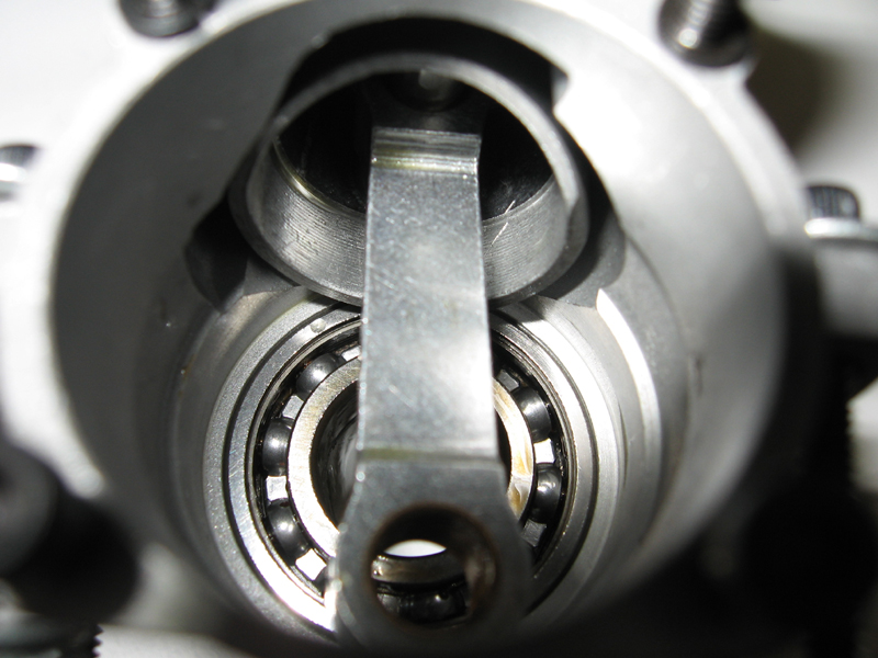

On the evolution .36 piston there is a portion of the bottom circumference of the piston that has a slight upward curve to it as seen in the picture below. When I disassembled the head and pulled the crank shaft out, I failed to notice whether this curved area was facing to the front (towards the carb) or to the rear(towards the backplate). I cannot tell for sure, the piston will go in either way, in the picture the curved area is right in front of the camera, facing to the rear. You can see it clearly in the picture below. Anyone know? I can get it back together no problem, I just want to be sure that I have the piston oriented the right way.

The cut out goes towards the front.
If you didn't remove the rod from the piston, this can be confirmed by looking at the big end rod bushing. The side that goes towards the crankshaft has a chamfer on the inside edge. The back plate side is straight.

If I understand you correctly then, in the picture the piston is sitting 180 degrees opposite of what it should be?

Is there a "notch" or recess in the backplate for piston skirt clearance when the piston is at bottom dead center?
The engines I have dealt with, that curved bottom of the piston skirt is usually for backplate clearance.
Edit: Taking another look...it could be for counter-weight clearance?
Mike, can you post a pic or 2 of the backplate?

Mike, Tom,
This is exactly what this cut-out is for.
Some engines have a flat in their back-plate, so the uncut piston-skirt will have clearance.
On the rotating crank-web and the rear bearing, such a flat cannot be machined... so the cut-out must be in the piston skirt.
Many engines may have no such 'cut-out' in their original, small displacement version.
But when the manufacturer 'strokes' the engine to offer versions of increased displacement, the piston will have a cut-out at its front; or if there already was one, it will be larger for the stroked version.
This way, the piston can descend further down without hitting anything solid...

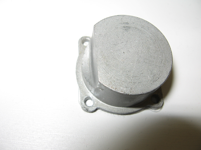

I found the exploded view of the engine and it appears that the cutout goes to the front. Reading what you guys have been discussing, it makes perfect sense that the cut out is oriented so that the piston can clear the crankshaft counterbalance. The backplate has a cutout in it so that the piston skirt clears. Seems logical now.
