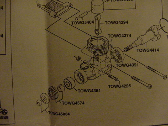

Guess what.
Thats the first thing I looked for.
I have none.
The cone rides up against the face of the bearing race.
I hope this photo comes out OK.
The bearing goes into the housing and the cone rides on the bearing part that turns.
Photo looks OK.
Take a peek

I just posted a picture of the engine break down of the parts.
There is no this washer

I can't put in what is not there.
Even the picture showing the breakdown of parts don't show it.
OOOoooooohhhhh,
I just read the parts list and they list it as 1 part called Drive washer cone.
Well,I don't have one so I guess I have to call TH.

Whirley Bird...if that parts view is correct for your engine then it's ball raced so won't have the shim washer. It seems there was an assumption made that you have a plain bearing engine and they're the only ones that need that shim (they don't use a split cone either).
What I'm curious about is if the engine feels free to turn (other than at the top of the stroke) without a prop and then gets hard to turn when the prop is put on and tightened. If so then there's a problem with bearing clearances in that tightening the prop forces the inner race hard back and binds the bearing. That's cause for a replacement engine. It's rare but tolerances can gang up to cause it.
The picture does not show that washer.
But I looked at the parts list and it's under one part number as drive washer & cone.
The engine is the Tower Hobby PRO 46 BB ABC ENGINE.
The engine was very tight until I put some oil into the cylinder.
I put the prop on and it's very loose and gets very tight when the piston is near TDC so I guess i'm OK?

Whirley Bird...you'll be fine with it then. What I think you're feeling and worried about is the just the pinch of the piston near TDC. But with an ABC (and particularly a new one) it's not a good idea to turn them over slowly, give the prop a good fast flick to get the piston over the top. Because the piston is an interference fit in the liner the oil gets squeezed out if turned slowly and then you're down to metal to metal. Use some castor in the fuel because it resists being squeezed out much better than synthetics.
The same goes for plain bearing engines: if you turn them slowly with the plug installed so there is compression, the oil will get squeezed out from between the bushing and the crankshaft...don't do that...
