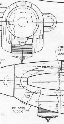

For you and others, I scanned an image off original plan to helpt you better visualize the situation. This ought to help some, and let you get the feeling.
It is a middle 1960's racer, had a K&B .40 up front. As you may see it gets rather tight around the cooling fins. Nothing in the notes, nor on the plan as to suggested clearances. Makes it look as though the intended balsa block cowling was to fit tightly around the engine.
I am going to install a slot at the firewall to let air out. Nothing decided on inlet yet.
Wm.

Stop worrying. The cyl. head is out in the breeze. That is the key bit.
Add a hole to feed the carb and bias/duct the air around the EXHAUST SIDE of the engine and make a hole somewhaere at the back to let the hot air out.
That should do it.
