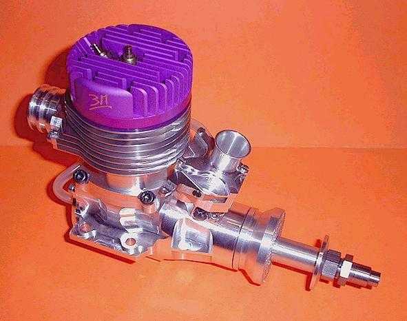

The 3m mintor is certainly different with cnc aluminum body and two glow plugs. Why two plugs ??

Rajul,
I heard the dual-plug helps on the idle.
Some people using OS 140RX swapped their engine head with 3M 140's.
3M is also lightest of the three engines.
It is probably the cheapest because it comes with two headers while the Webra and OS don't.
Almost equivalent power, and if the warranty service become available as OS, I am definitely sure to have one.

Does it improve the acceleration/deceleration compared to single plug ? I am also wondering how does one attach the glow igniter to the head ? Is it better with a remote glow igniter with parallel connection to the plugs ?

Rajul,
I have no idea or heard anything that the dual plug will improve transition. Only better idling (lower rpm).
For the igniter setup, I have no idea, I will try to look for any info on that in my archive and post.
Maybe someone can answer this?

My guess is that you don't need to heat both plugs to start the engine... use the one that is mounted vertical, the other one will get hot very quickly...
If you want to heat both plugs you can also put them in series. All you need is 2.4 V instead of 1.2 V and one plug connected to the negative side of your power source and the other connected to the positive side...

You don't need to light both plugs. Only one is needed to start the engine. The second plug is heated just the like first one is after the battery has been removed - by the ignition of the fuel. And then, just like normal, both glow plug elements remain hot until the next cycle.
