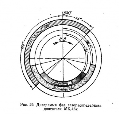

#30
The front end governs the timing of opening into the crank and this should be moved 90° in the forward rotation direction of the engine. It will then end up on the other side of TDC, and the engine will now be correctly timed when turning in the opposite direction.
So seen from the cockpit the a regular engine turns CW and the front end should be rotated 90° in that rotational direction. With an uppright mounted engine the carb will then be on the right-hand side of the plane (as seen from the cockpit). The two positions are the only two possible positions where the engine will run, but it will run in two different rotational directions.
The trick works if the crank timing is symmetrical around 45° before TDC, it is then shifted to 45° after TDC and the engine needs to spin in the other direction.

#34
It DOES work as I described it. Okay, I didn't run the engine in the three alternate configurations, but hand-rotated it through each to observe the sequence of 'case intake' shaft porting, compression and exhaust port sequence. (Plug removed, 'front end "loose" but held fully in place.)
If one would rotate this intake timing by 180°, then the intake port would not even be open around TDC, so clearly that doesn't work...
#35
Mr. Cox, surrender and greater thanks!
CONCLUSION: Rotating the front housing 90° in the direction of stock prop rotation works. 'Nuff said.
Again trying it with the 35 III, with more careful observation of shaft port timing, I concede my error. In the intake shift against stock rotation direction, there is an occasional similarity of port timing, but it is not near the 'stock' numbers. Thus not usable. At the 180° shifted position, : The shaft port was open on the downstroke. It would pump any 'closed-case' volume OUT, not draw flow IN.
I can only figure that the 'intake moved left' proved an easy and effective solution, so I did not scrupulously check out the other two possibilities. Glad to learn this, finally.
A possibility: the Fox factory 'LH Shafts' simply reversed the 'side' of the intake 'hole' to the other side of the crankpin. As stock, the RH shaft is cut so that the 'opening edge' is aligned with the crankpin centerline -to- shaft centerline, and the full opening "lags" about 90° after in the prop rotation direction.
The LH shafts have their 'opening edge' located the same, but the full opening is to the other side of the pin-to-center line. Mirror-image, done completely by location of the rotary shaft inlet port. No wonder it runs identically as the stock shaft, but turning the other direction...
