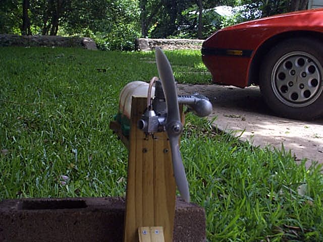

Hello guys,
I read somewhere that it is possible to reverse the rotation of a glow engine like Super Tigre or Webra, which have a front case cover with bolts, by rotating the front of the crank case (with the carb) by 90 degrees - is this in fact possible, and if so what should be done ?
this is in order to reverse rotation on a glow engine to make it a "pusher" engine in fact, with a standard prop.
It is very possible. Rotate the fronk crankcase piece 90 degrees to the right - looking at the engine from the prop shaft (front).

You have it right, from the front of the motor, rotate the front housing 90 degrees counter-clockwise. The engine will run backwards and be within a few hundred rpms of before the mod.
Just curious, what do you gain by reversing the engine vs using reverse pitch prop. I guess I'm assuming that it is an aircraft engine.

What if someone were to rotate the front housing on a .46AX, and then use a pusher prop on it. Stick it on the right (correct me if i'm wrong) side of a Dual Ace (for example) with a normal .46AX on the other side. Just richen until at identical revs. It would be very risky running one engine that lean, but I think it'd be cool to see a Counter-rotating R/C Twin-engine plane. What do y'all think about that??
Vic, Ideally that is what you would want. The torques (via rotational inertia) created by the engines would cancel each other out. Ever notice that many models have firewalls angled to the right? With counter rotating props the angling would not be necessary. If the angling of the mounts/firewalls was desired, the counter rotating engine's firewall would be angle to the left.
OS .46 AX engines have a one piece crankcase and cannot be made to counter rotate without serious modifications to the crank.

If you can find or can turn/CNC a reverse rotation crank there would be no reason to rotate the front housing 90 deg to the exhaust side and the R's, in theory, wouldn't change.

If the reverse rotation crankshaft is machined identically to the normal crankshaft, there shouldn't be any real power difference.
If the K&B crankcase is turned around, no flow differences will occur inside either.

Sorry, I don't mean to change the subject (cough), but I just picked up an APC 10-6 pusher prop and will try the K&B both conventional and counter-rotational using the 90 degree trick discussed. Lets hope I get the same RPM. I'll post my results....
I had a chance to annoy the neighbors today with my engine tests. After not having run for 20 years my old K&B 4011 fired right up but would not hold an idle. After replacing the dried up carb seal with an O-ring I was back in business. In standard configuration with an APC 10x6 the K&B ran wide open throttle at 12,200 RPM. In the configuration shown below with an APC 10x6P (pusher) the engine ran wide open throttle at 12,100 RPM. That small a difference is so small its negligible. Throttle transition in both configurations was better than my OS40SF's! I gave up on the K&B years ago because of carburetor issues but have to say I'm impressed with this little engine.
Joined: Oct 2006
Posts: 1,731
From: Greenville, SC
Well, that's great to hear!! I'm glad you've run the tests and found that. I'm guessing that's NOT using the reversed crankshaft, right? Have fun with that!!
