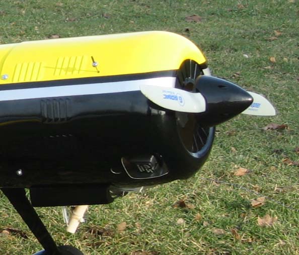

Hi everyone, here's some experiences with my FS200:
POSITIVE
- Reliable, starts easily with a starter, I also successfully hand started it
- Uses very little fuel, runs about 10 minutes on 350ml with mixed throttle settings
- Low vibration for an engine of this size
- Quiet with standard muffler
NEGATIVE
- Performance could be better (7700 to 8200 on Graupner Sonic 18x8)
- Oil loss through the hole on the back of crankcase - did have to put a wooden plug in it to stop this
ISSUES
- I do loose power after some time when the engine runs full throttle - I believe it is an overheating problem
- The cylinder head (intake/exhaust, valves) is a bit hidden behind the cowling, the rocker cover is in the airstream as well as the cylinder below the head (see picture)
Does anyone have similar issues with power loss when hot? If the engine is cold, my Yak takes off after 10ft, if its hot it barely hovers.

Couple of things Chris.. Any aircooled engine that is "hidden" will overheat no matter what. In the photo you uploaded, there is not nearly enough ventilation for the high 3D loaded engine. You need to fully open the front of the cowling and cut a BIG opening underneath it, and use at least 18% of oil, no matter what the quality is..

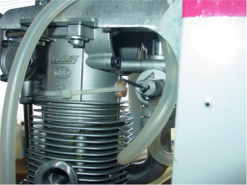

Secondly, the hole at the rear body of the engine blockyou are talking about is actually an access hole to remove piston pin retainers. It shouldnt leak under normal operation as it is completely sealed with the cylinder wall against it.

Thanks - I guess the photo is not that great. The front opening to the cowl is about twice as wide as the cylinder (difficult to see), and the outlet underneath the cowl (not visible) is at least wice as big as that. But I guess I still need to open up the area in front of the cylinder head. I am not sure if openening the whole front of the cowl would improve the situation a lot, as most of the air will just pass the engine and it needs to get out again.
I'm just wondering if anyone with the FS200 has had similar temperature problems...
The hole in the back is really annoying - it has leaked a substantial amount of oil from the very beginning. Hans Meij in the post above had similar problems, and another guy from Germany reported his engine had started leaking after some time, too. Former Webra engines had a screw in there that sealed the hole nicely, I wonder why they left it open on a quite expensive engine as that.

You might experience oil coming out the wrist pin access especially if you run the engine inverted.The design somehow allows oil to collect between the liner and crankcase which is forced out thru' the hole barely 5mm from the gap via crankcase pressure.I think a redesign is in order or wait till the oil gets baked on and plugs the gap!

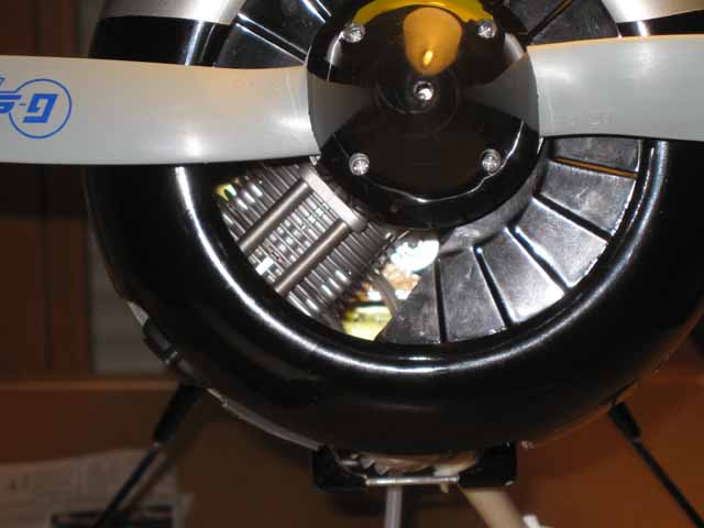

This is how the cowl and air outlet look like. I am running 17% high quality synthetic oil (Aerosynth3), 10% nitro.
Has anyone else experienced similar overheating symptoms as me with an FS200, e.g. comparison with/without cowl?

No, the plug is actually not in the crankcase ventilation, it is in the access hole that is required to mount the conrod. The hole is already covered by the cylinder liner, but it still leaks oil (see picture from Hans Meij above). The crankcase breather is open.
