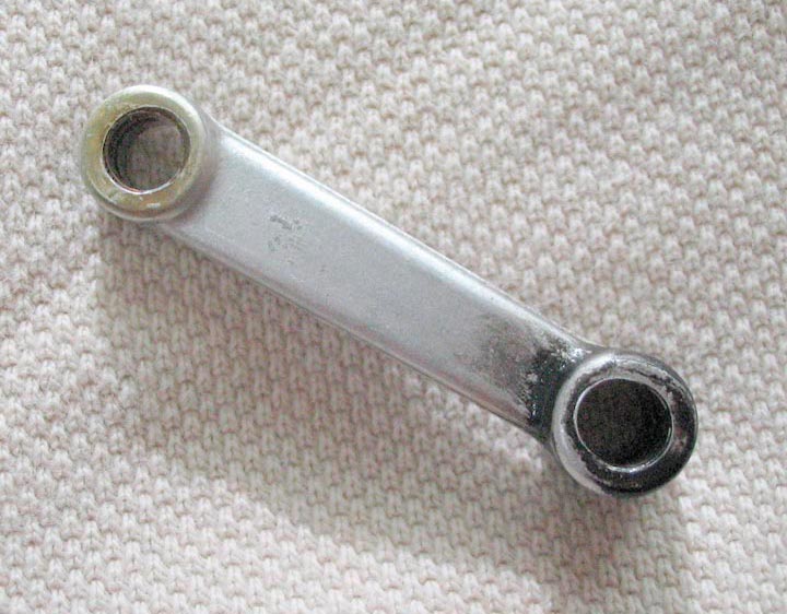

I'm aware of those things, Flyer 95. What I'm not clear about is precisely what kind of damage was done and is being questioned. Wearing of the bearing material can be attributed to poor lubrication from lean runs or bad fuel (lack of lubrication).
Starters bend connecting rods and crankpins, they do not normally cause a deformation of the wrist pin end of the connecting rod. This is what I'm trying to get out - without success.
Dar Zeelon pointed out one way that deformation can occur in a four-stroke connecting rod's bushed areas. I accept that, but we're all just guessing without more information.
A few photos photographed close-up to the damaged connecting rod in question would be a tremendous help.
Ed Cregger

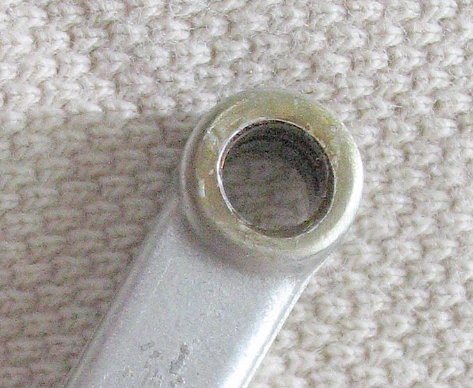

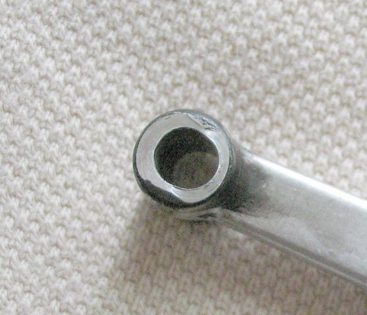

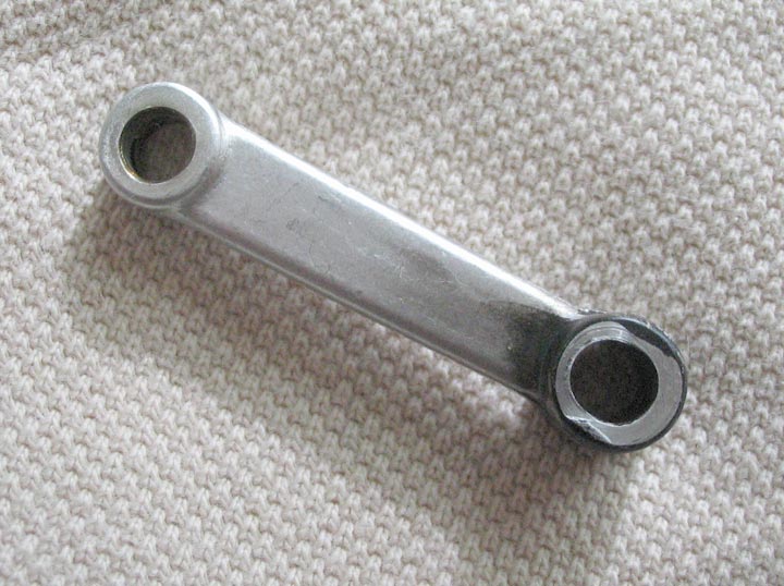

#42
David,
This definitely appears to be compressive overload damage...
This con-rod seems not to be bushed at either end.

#46
Looks a lot like the K&B .40 rods I mentioned...whupped!
Over-heated... maybe by too much prop, and too lean?
The bottom end looks like either it has remnants of a bushing, but it might also be (no bushing ) just discoloration from varnish and or a little rust residue in the chamfer?
You can also see where the top end of the rod was rubbing the pin bore's boss in the piston...must have been fore/aft thrust loads...it may be a slightly bent rod too, or just rocking caused by the wallowed out hole?
#47
My Feedback: (19)
ORIGINAL: yallaair
Or limited lubrication... Non bushed conrods need better lubrication. The conrod has definitely been overheated. You can see the black varnish from carbonized oil. This overheating can be a result of compressive overload together with bad lubrication. I have never seen carbonized oil on conrods at normal operating temps before.
That is exactly what my MVVS .15 diesel looks like. i ran it quite a bit when I started the hobby. I never thought I ran it over compressed, but it did run it with a tuned pipe on it. Being so long ago I'm not sure. I had black carbon near the small end of the rod. Aluminum gets soft when it gets hot, so I think that is the main cause.
