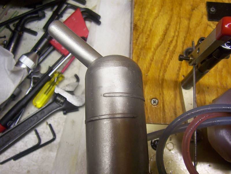

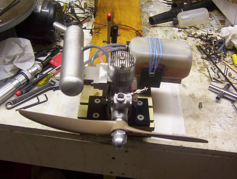

Ed, I ran it just a few minutes ago, I used, as always Fox 5%/20% castor, it's 25 degrees here, it started right up but had a little trouble idling for more than just a couple of seconds. I changed from a Fox idle bar plug to a Fox Miracle plug and that took care of the shaky idle. I took a shot of the baffles in the Bisson, as you can see they are open on opposite sides giving it a deep, very cool sound.
Temperature 25 degrees MVVS .61 Long Stroke
Fuel Fox 5%/20% castor
Prop==Bolly 12.5x8
Max rpm with Fox Idlebar plug 10,775
Max rpm with Fox Miracle plug 10,825 with steady 2,100 rpm idle

That sounds like a really strong engine, of the OS .61 RF/SF type of strong.
A friend of mine owns an older OPS long-stroke .61 and a Moki similar to yours, if not the same model. He used them in an Omen pattern ship and they both provided very good power for that type of a pattern ship.
I have a shoe box full of used OS .61 SF's I have to go through and dismantle, clean and rebuild. I haven't checked as yet. I hope they are all large rear bearing versions.
I wonder what kind of bearing life one can expect with the smaller, original rear bearing on a piped engine?
Ed Cregger

I ran an early small bearing RF for a season without problems. There were some pattern flyers who had problems, I never got to examine a failed bearing. I would not worry about it too much considering old Saito 120s used the same rear bearing as an OS 40.
