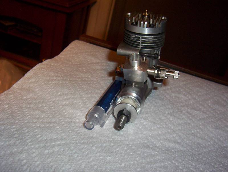

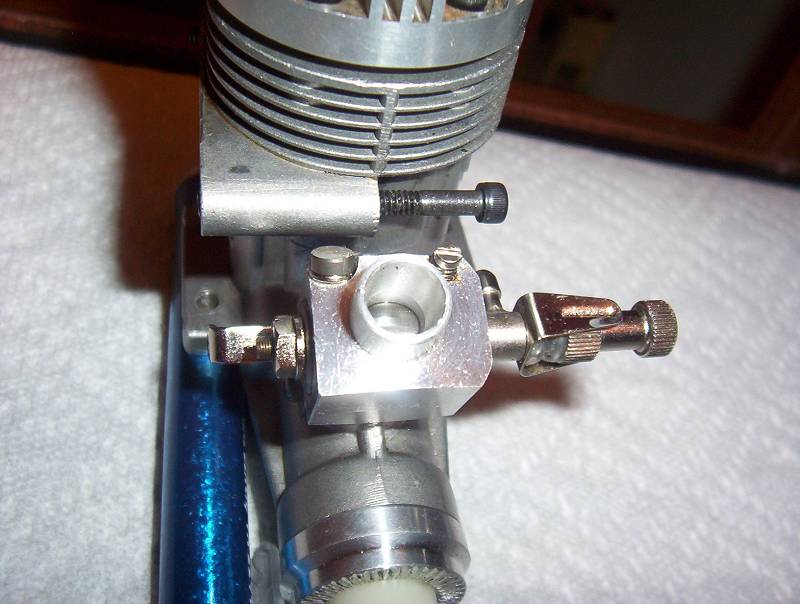

Here it is, it weighs 16.7oz with stock muffler and 18.7oz with the MDS .58 baffled muffler I use on it.
ID:	892721   Click image for larger version
ID:	892722   Click image for larger version
