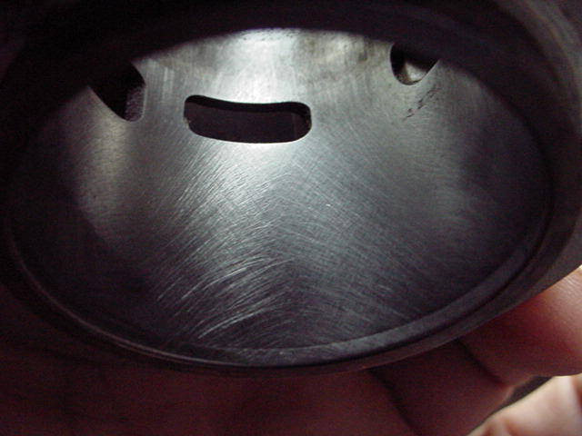

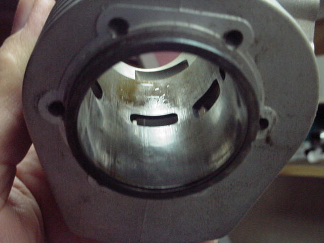

....use a coarser paper to prepare the cylinder wall...150 is good.
400 won't scratch the surface enough. [)]

....use the 150 paper and make it look like this if want the new ring
to seat properly. [)]
FBD.
