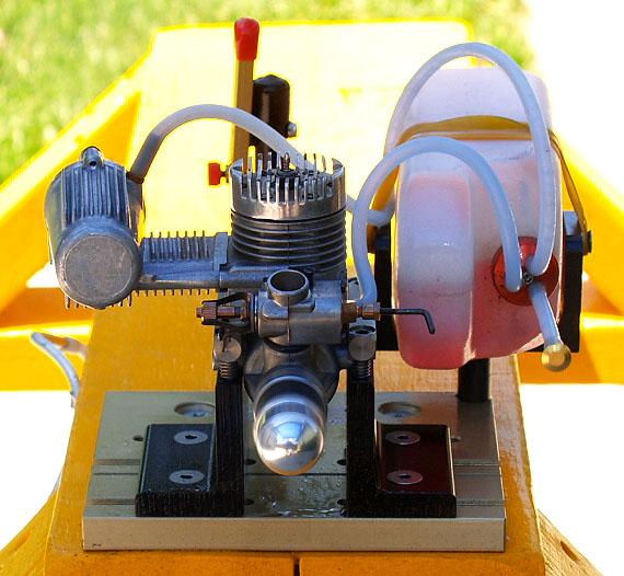

12900 on a MA 10x6 and Powermaster YS 20/20. Might get more if I tune the carb better. I initally forgot what needle was what. So after smacking my fingers 4 times I left it that.
102°F OAT.
