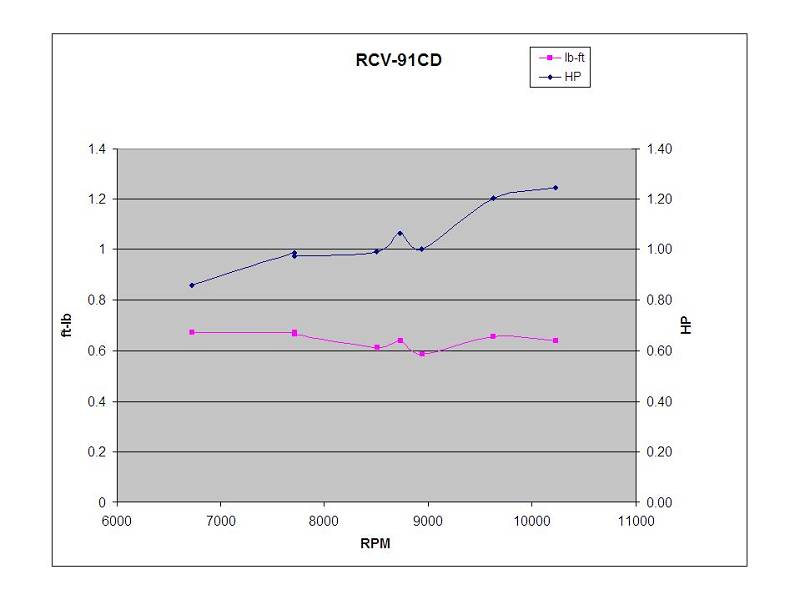

#34
My Feedback: (19)
Oh something got screwy with the plot. I looked at the curves more than I paid attention to the axes. The plot looks more reasonable. I still question such a high peak in HP and what looks like another of similar magnitude at near maximum RPM. This is not a typical torque curve for a model engine as the intakes and exhausts are not of dimensions that would allow this sort of "tuned" breathing.
#35
My Feedback: (19)
Compare this to the much more common curve of the RCV-91CD. I doubt there is an significant design difference between the two engines. These figures are calculated from the Fly RC review I mentioned. The curve is very flat and and the greatest torque was obtained at the lowest RPM of 6720, slowly dropping as RPM increases.

Greg,
I guess most model engine manufacturers do not have a PhD in rocket science...
So, as engineers, they would usually just 'slap together' combos that work.
Occasionally; especially with an engine like no other, like this RCV; some variables do act together, through resonance, flow-speed, orifice sizes, Etc., to cause a nearly vertical, marked drop (or a peak) in torque, over a very narrow RPM span.
I would urge Juice to set that 18" prop to pitch numbers around 12", in 0.5" (or smaller) increments; and to take RPM measurements, to see where this drop actually happens. It is in the engine's internals, so we might not know exactly why it happens, however.
Ye hear, Juice???
As you can see from your graphs, since the left side and right side axes are now 'synchronized'; the torque (now in lbs.ft.) and the HP curves will intersect at 5,252.1 RPM, as I wrote in the previous posts.
"I love it when a plan comes together" (Now, who said that???)

#37
As to the latest post, Greg, the numbers just don't coincide with Juice's observations and RPM readings...
Also, would that RPM represent actual crankshaft RPM, or prop RPM???
This engine is not supposed to run at these prop RPM numbers, although its rotary valve actually does not have the RPM limitations of spring-loaded poppet valves.
As to absolute HP; I believe the generic prop factor Pé supplied in his PropPower, may be too low, for the wide-blade 'Hamilton Standard' look-alike prop Juice is using and I already remarked in regards to this in post #31.
But as to the torque, as portrayed by Juices numbers, I can only call them as I see them...
I don't know if the engines actually differ, but they do show different numbers.

#38
My Feedback: (19)
Yes, Dar they do intersect when using these units. It doesn't prove anything, it's simply a fact of the torque/hp relationship. That doesn't change the fact that the curve is not reasonable. I stand by my interpretation of the data presented that the torque figures near 4400RPM are erroneous. To truly learn anything we would need first to verify that the marked pitch on those prop is accurate.
See, the people at RCV are engineers. This is why I doubt such an odd curve is real.

#39
ORIGINAL: gkamysz
Let's now see if Juice can produce RPM numbers for fractional pitches, between 11" and 13" for that 18" diameter prop...
The numbers don't lie and the fact that the RCV people are engineers, does not immunize them from creating bumpy torque curves...
It is not an engineering error.
What does seem to be extreme in that drop, that not only is it a drop in torque, but that even the rise in RPM did not prevent the HP from falling also.
Actual dips in the HP curve are rather rare (except after peak HP), while torque dips are all over the place.
If we could only ask RCV about it... We'll see what they say.
#40
Wow... Good discussion Dar and Greg! I just got home from a long day (which, by the way, included flying with the 18x10 3 blade prop again) so I'll have to read everything carefully tomorrow. Some of the discussion is over my head at the moment. But that's why I posted the question... so I can learn new things from people like you guys.
I'll try to get those RPM numbers... If not this weekend, next weekend for sure.
Dar... One thing I'm wondering is if you are taking into account the 2:1 gear reduction in your calculations. The RPM numbers I'm posting are the prop RPMs. The piston RPMs are 2x the prop RPMs. Again, I have to read everything carefully still, so if you have already taken it into account, please forgive my ignorance.
(Hopefully, at the end of it all, I'd like to be able to fully understand everything that was talked about here, and be able to make these types of calculations myself. I hope you don't mind me asking you dumb questions.
Juice
)Juice
#41
ORIGINAL: Juice
Dar... One thing I'm wondering is if you are taking into account the 2:1 gear reduction in your calculations. The RPM numbers I'm posting are the prop RPM. The crankshaft RPM is 2x the prop RPM. Again, I have to read everything carefully still, so if you have already taken it into account, please forgive my ignorance.
Horsepower calculations do not take into account reduction drive ratios, since work is not affected...
Applying a force over a distance per time unit is equivalent to applying twice the force over half the distance.
Even though the torque is roughly doubled (I take gears at 100% efficiency), the HP output produced is unaffected, so the reduction ratio does not need to be taken into account.
When the power absorption of the prop is used, the engine is regarded as a 'black box' which produces this output... The RPM is what the prop is spinning (crankshaft RPM cannot be measured in the engine...).
I only mentioned these facts in my posts, since Greg posted graphs that got to 10,000 RPM (which is the actual crankshaft speed) and in some graphs he posted torque figures, that are roughly double those of typical .91 four-stroke engines... I felt an urge to explain...
I did not actually state any torque values; just comparative numbers, to show if torque is higher at one point than it is at another.
We will be waiting for your results... Do the larger and smaller props too, please, so we can have all the results together, at the same measuring sequence.
No need to apologize... People don't know this until they learn it.
#42
My Feedback: (19)
ORIGINAL: DarZeelon
#43
ORIGINAL: gkamysz
Dar, this is ridiculous. If you are stating HP values, there are torque values to go along with them since we know what RPM they were produced at. You just neglected to convert the number to a common unit.
...But since I entered that whole mumbo jumbo regarding the 5,252.1 (...), I did not want to get into fractional torque values in lbs.ft., or to use oz.in...
So, yes, I did neglect to convert, but since I looked for the highest value, A>B is just as good as 1.31>1.19...
All well and good. But that prop looks totally SWEET!!!!!!!!!!!!!!!!!!!!!!!!!!!!!!!!!!!
