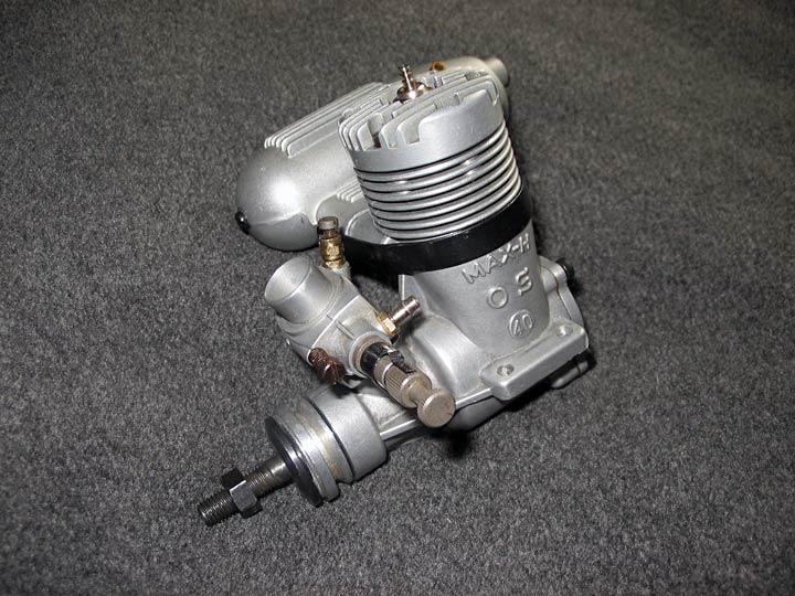

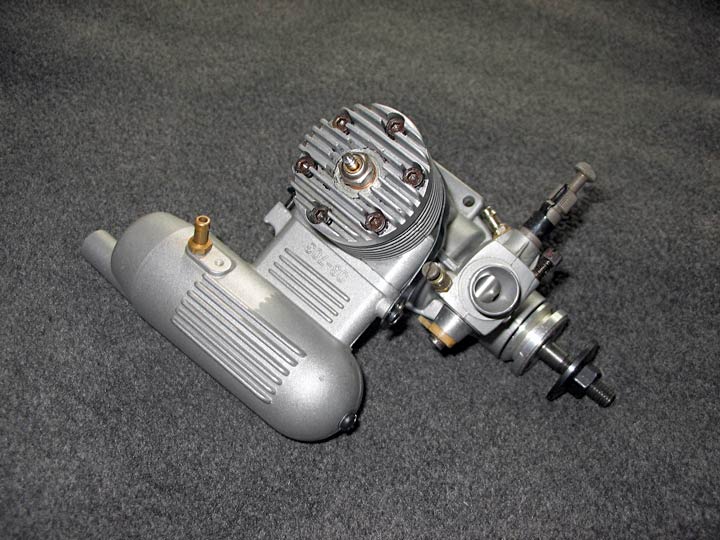

You have the OS #703 muffler. Here is the auction number for a strap:
120307027465
I have several OS's with these mufflers and they work fine.
David

The OS strap on mufflers came in three sizes - #702 for the MAX .15, .20 and .25, #703 for the MAX-S .30, MAX-S .35 and MAX-H .40, and #704 for the MAX-H .60 and MAX-H .80. The 702 and 703 mufflers and straps are still very easy to buy and commonly come up on auction sites, but the 704 seems to be a bit harder to get hold of.

BTW, the #703 fits the .50 and .58, too.

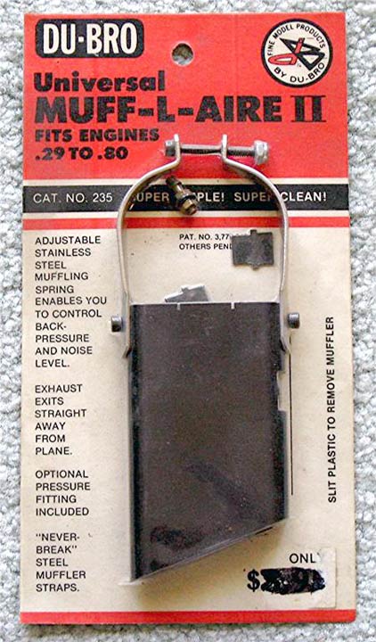

I found one last year at a swap meet. The seller was busy on his cell phone and I held up the muffler and a five dollar bill. He nodded yes, so I left with a bargain. The last one I saw on the auction site went for $52 and change!
I haven't given up, but I bought one of these old Dubro jobs which is better than nothing. It has a spring inside and you can adjust the tension to alter back pressure and noise level.
David

Love that old Muffler.
The GREAT UNIVERSAL MUFFLER. FITS EVER ENGINE IN THE WORLD... REGARDLESS OF SIZE!
(regardless of performance a well one thinks[sm=50_50.gif]?)
Also love the note: "Split plastic covering to remover muffler" on the package.
Obviously, Dubro must have thought that those taken in by the "Universal muffler" spin would be of such limited mental capasity, they deemed it necessary to include the instructions for opening the packet!
Not distracting from your purchase Dave... just laughing about the old days.
