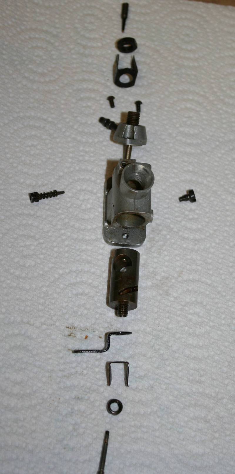

Picked this up with a garage sale Zero
Says FOX on the carb, but no other marking whatsoever. I measured the bore and stroke and came up with .89cu" (so a 90?). The case is 2 piece with the second half on the back split right across the cylinder centerline. Will add another photo later (tear down)
Was gummed up bad, but turns nice now. Low speed needle was broken as well as the ring having fractures (came out in 3 pieces)
Anywhere to get parts for these? I didn's see them on the FOX Mfg site...
Thoughts?

You can get a ring from Frank Bowman
[email protected]
Frank C. Bowman
1211 N Allen Ave.
Farmington, NM 87401
505 327 0696
for new bearings http://www.bocabearings.com/
I don't know that they ever made a 90. They made a 78 and a 74

It is a Fox .74. You can get a ring from Fox as well. If you go with Frank Bowman, you may need to send the engine so he can custom fit it.

thanks for the info on the parts. I used a machinists ruler to measure the bore and stroke (Don't have my mic or calipers here) but I dont think it was as small as .74 or .78 based on the crude measurements....
I'll give Frank a call and go from there...
thanks again!

Thanks.. Between how the bearings look (and now that it's loosened up) how they feel, it'll certainly need bearings.
I remeasured and then used the right formula (misplaced the brackets in the piR2xH the first time)
Came up with 0.53495552 using more accurate measurements and the right formula.
Would this be a .50 then? not sure if they made a .53 or .54. Cannot find a lot of info on their engines. Surprised I couldn't find any other marking than what was on the carb.
Calling FOX in the AM to see what they come up with.

I know Fox made a .60 and .74 in this configuration. Certainly it is not a .50 or .55...
Fox Mfg should be able to sort things out. If you don't feel a need to buy a bunch of new parts, consider a crock-pot/antifreeze soak to clear away the congealed castor. The ring, definitely, needs to be replaced if it is cracked and broken as you said. Unless the cylinder bore got scored by it, you may get off lucky.

The bore and stroke for the .60 is .905 bore and .937 stroke, the bore and stroke for a .74 is 1.00 bore and .937 stroke. That appears to be an early .60.

Picking up my Micrometer and Calipers from the brother in-law that borrowed them a while back tonight and will re-measure, but with a machinist ruler it’s .88” bore and stroke.
I spoke with Charles at Fox this morning and am sending him these photo's as well as these #’s and we’ll see what they come up with. He seemed to think it was an old .60 as well based on my descriptions.

So when you get the right tools, the job is alot easier... got my calipers back last night and confirmed the .60" size.
Bore .905", stroke .937" ring thickness .046"
Frank said he has the ring for $13.00 and I'll be following up with Charles at FOX later to get details on bearings or if they have a package "overhaul" deal...

Your engine uses a 6903 bearing in the rear which is $4.97 from RC Bearings
and it uses a R6-2RS in the front which is $3.97 from RC bearings
That is $9.94 plus shipping from RC Bearings
