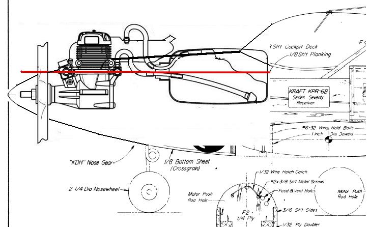

ORIGINAL: Trisquire
A little closer:
There are common in aerobatic plane, 3D etc.. but if your engine are flooded by fuel (siphoning fuel into engine), move the tank a bit lower.

IMO the diagram puts the tank at just the right position.

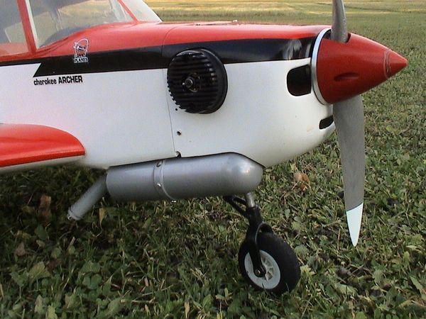

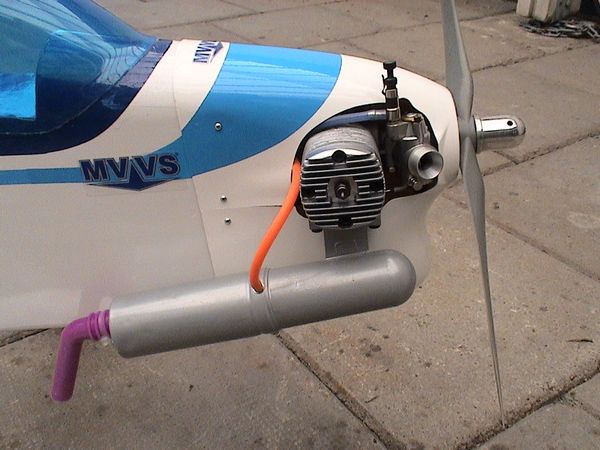

Hi!
Tank position is a big problem if you mount the engine up-right!
A much better position is to mount it sideways.
ID:	1265731   Click image for larger version
ID:	1265732   Click image for larger version
ID:	1265733   Click image for larger version

I kinda like the sideways mount too. Even more now that I have seen how important tank position can be. Would have been nice for WM to have pointed this out in the instructions befor I cut me cowling like the book said. But I guess if you learn something from it the mistake was worth it. Just a note for models makers. look at the Aeroworks Edge 540. They not only went with sideways, they put a diagonal slant to fit the cowl without alot of bucthering. They even offered options for other mounts with engine and tank aligned in all of them. I call that quality in a kit, even an ARF.

I have found side mounting an engine makes getting the tank / engine setup very quick and easy. The result makes for a dependable and powerful setup as it will hold a setting for the entire tank. I know you have seen alot of ideas. I hope you can find a system that works well for you. I know I tried several before I was truely happy. Good luck in your search......
