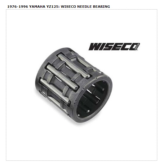

What exactly is a needle bearing ?
I am referring to ball bearings,like the two of them that support the crankshaft of many glow engines.
Is there any manufacturer that uses instead of a bronze bushing ,to connect the crankshaft to the connecting rod, a ball bearing ?

I now understand you Kostas, but manufacturers don`t use BALL bearings in those places, but rather NEEDLE bearings. As a general rule only gas engines has bearings in those places (both ends/holes of the con-rod) There`s some exeptions and as mentioned some MVVS glow engines also utilize needle bearings in the rod. Just google and you will find out just what a needle bearing looks like

ORIGINAL: Kostas1
This is a needle bearing for a motorcycle engine. Another common term, correct or not, is "roller bearing."

O.S. uses a needle bearing in the big end of the connecting rod on thier OS Max H-80 engine.

I have a Webra .61 SilverLine that has a needle bearing at the top end of the rod. The needles in it are not caged but are loose fitting so it looks like there is room for one more needle. I assume that is deliberate so they won't crowd each other.
My OPS 30 Maxi had a needle bearing on both ends of the rod and could be run on 10% or less oil.
Asmund now i got it!
So the part that provides this friction-free ,spin, is not a ball but needle-shaped part.
Why these needle-bearings in such areas as the conrod,
are used only by few manufacturers.
I don't think it is the cost of parts.
And that assembly could give far better operation and smothness.

Kostas, the crank pin has to be very hard or have a hardened sleeve to risist wear when using needle or roller bearings. C&H Electronics used to do work like that to convert glow engines to gas but I think gave it up as too expensive.
